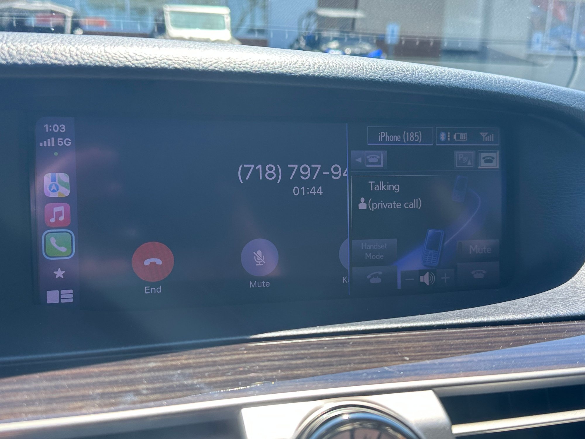

Anyone install a Naviks Carplay and not be able to view the full display? Mine only shows the left side of the display, meaning the side display is still on with Lexus info. Any help would be awesome. Thanks!

You can't see any of Navics info? Maybe the connectors didn't make good contact. Check all connectors. If that doesn't help, contact Navics customer service.

This might help. Had the unit professionally installed and technician was on lengthy call with Tech Support at Naviks. Naviks says it may be installed incorrectly but they also stated that my model Ls460, may NOT use the entire display. Going back to the shop tomorrow to try again. In the video on youtube, with same Gen LS460, it uses the entire screen. Was wondering if anyone knows how to turn the “Side Display” off. Can not find anywhere in the manual.

There was a switch from a double screen to a single around 2015-16, if I am not mistaken. It is possible that there is no fix, you will have to settle for what you have.

Press menu button next to toggle on console. You'll need to try different tabs for map only/full screen. It should be in the manual for nav system, not owners manual.

The 2013 nav does not do full screen maps like later models in this generation.

I installed a beatsonic unit a few months ago in my 2014. As others have said, in the '13s and '14s at least (I forget if this limitation went away in '15 or '16), the "side display" is always going to show the OEM screens, and you can only use the "main display" portion of the screen for Carplay. However, it looks like your unit is trying to send a signal formatted for the full screen. I don't have the instructions in front of me right now (and it's a somewhat different interface box anyway), but if I remember correctly, some of the DIP switches on the box have to be set correctly in order for the unit to be configured correctly for the earlier or later model year's screens. I'd double check the switches with the manual to make sure it's set up correctly for a 2013. When configured correctly, Carplay should format itself to fill just the "main display" area and not have things hidden on the righthand side.

There is a jumper setting, or a menu setting to change that. I had that problem when I first got my RoadTop Android Auto kit and there was a few swiches on the main box to change it so it deals with the split screen. You cannot make a 2013 use the whole screen.
Call the OEM of it to find the way to change it.

They changed the infotainment system in the 2016. This where you could use the whole screen. LS460 2013 to 2015 cannot use it, no hacks, no mods, the system is designed like this.
The rumor floated around that the HEAD unit from a 2016-17 is the only part that is the new system. This should be drop-in replacement. This should update the infotainment system and allow you to use the full screen. This not known 100% but, everything I have read points to it.
The problem? The cheapest USED one is around $4,500 and I would not spend that on a test.
