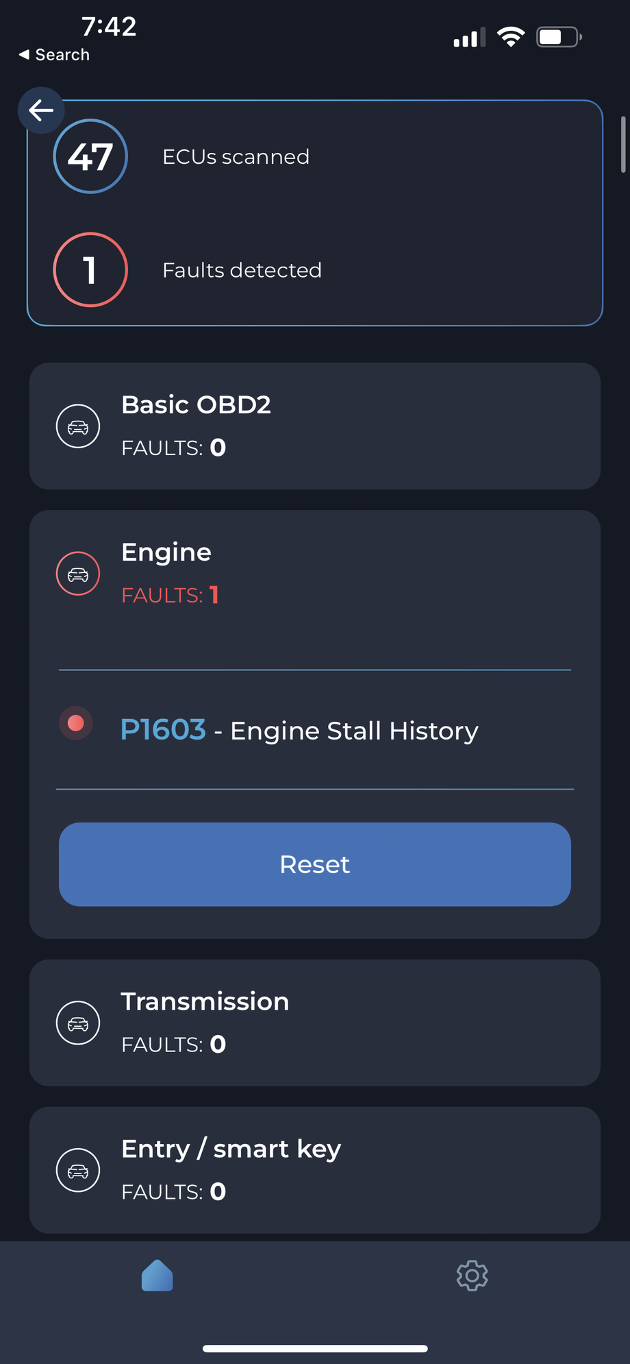

Btw this code is still showing up -
might have a faulty ECM if anything because battery is good on car

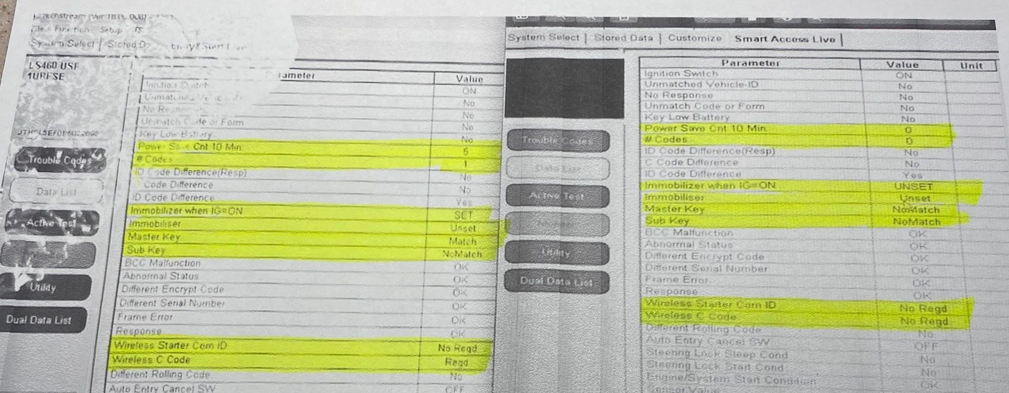

Maybe you did something accidentally when you were checking out the remote start, there are a couple of differences between our cars and they are 1 yr apart...
this screenshot was taken after this issue showed up.
Immobilizer when IG=On shows “SET” on my side-could this be an issue? Otherwise all looks similar I think

If they're not flashing the smart function isn't working, the fact that holding the fob to the start button works tells you the programming is ok...which was mentioned before.
Here's the highlighted differences between my 13 and your 14, they are basic default settings on mine. The only one I'm not sure about is the "wireless c code" because you said you were trying to get the remote start to work and it may be different just because of that. I always take notes or pics of what the defaults are when I am looking or changing things in TS, I know that doesn't help but I believe you may have changed something inadvertently because there is no other reason that the immobilizer and master/sub key settings should be any different on these 2 cars.
That's a lot of diagnosis time, about 7 hrs. try to get a guarantee in writing it will fix the problem before you sign off on it. Your car is on the left side.
