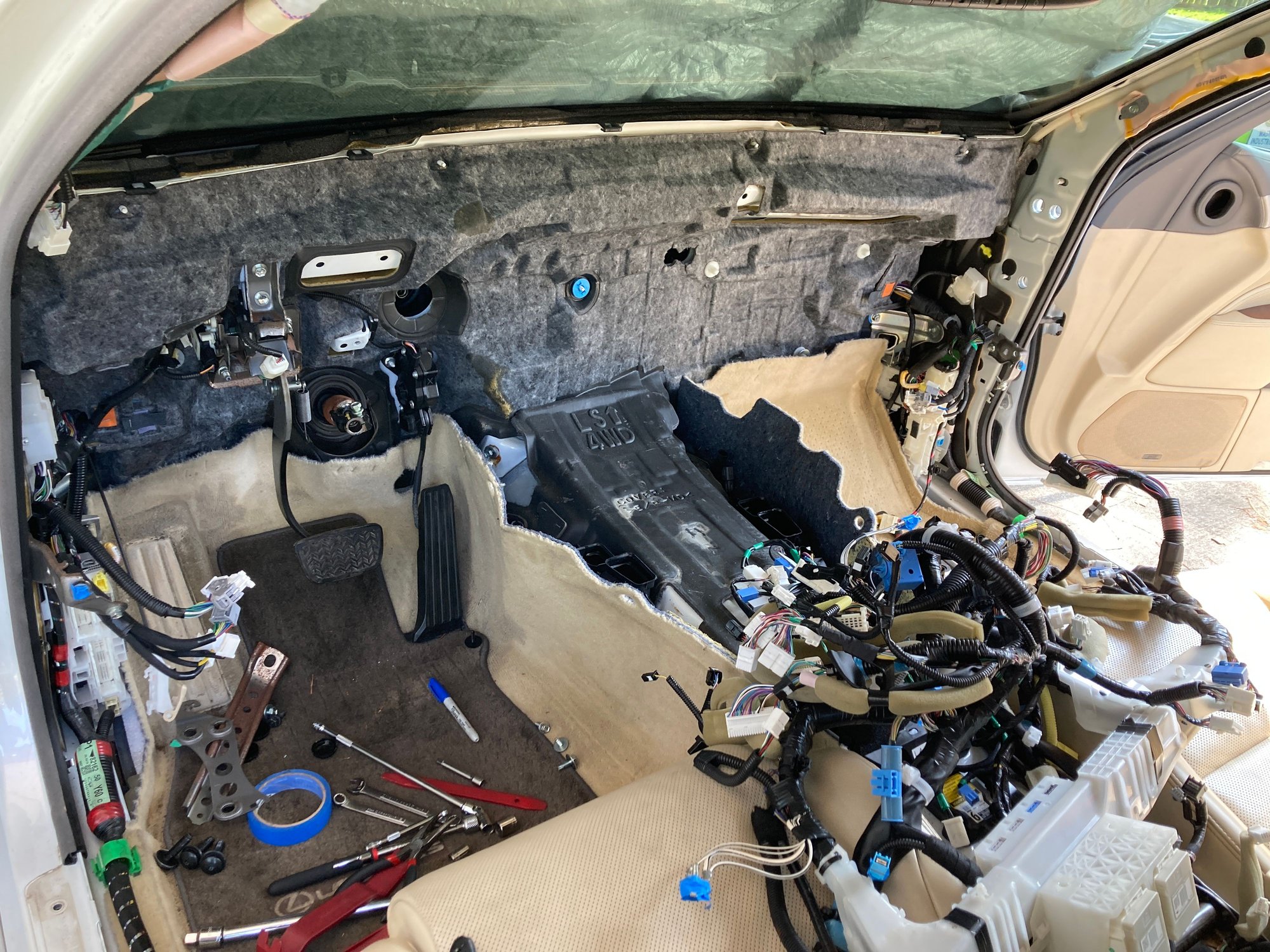

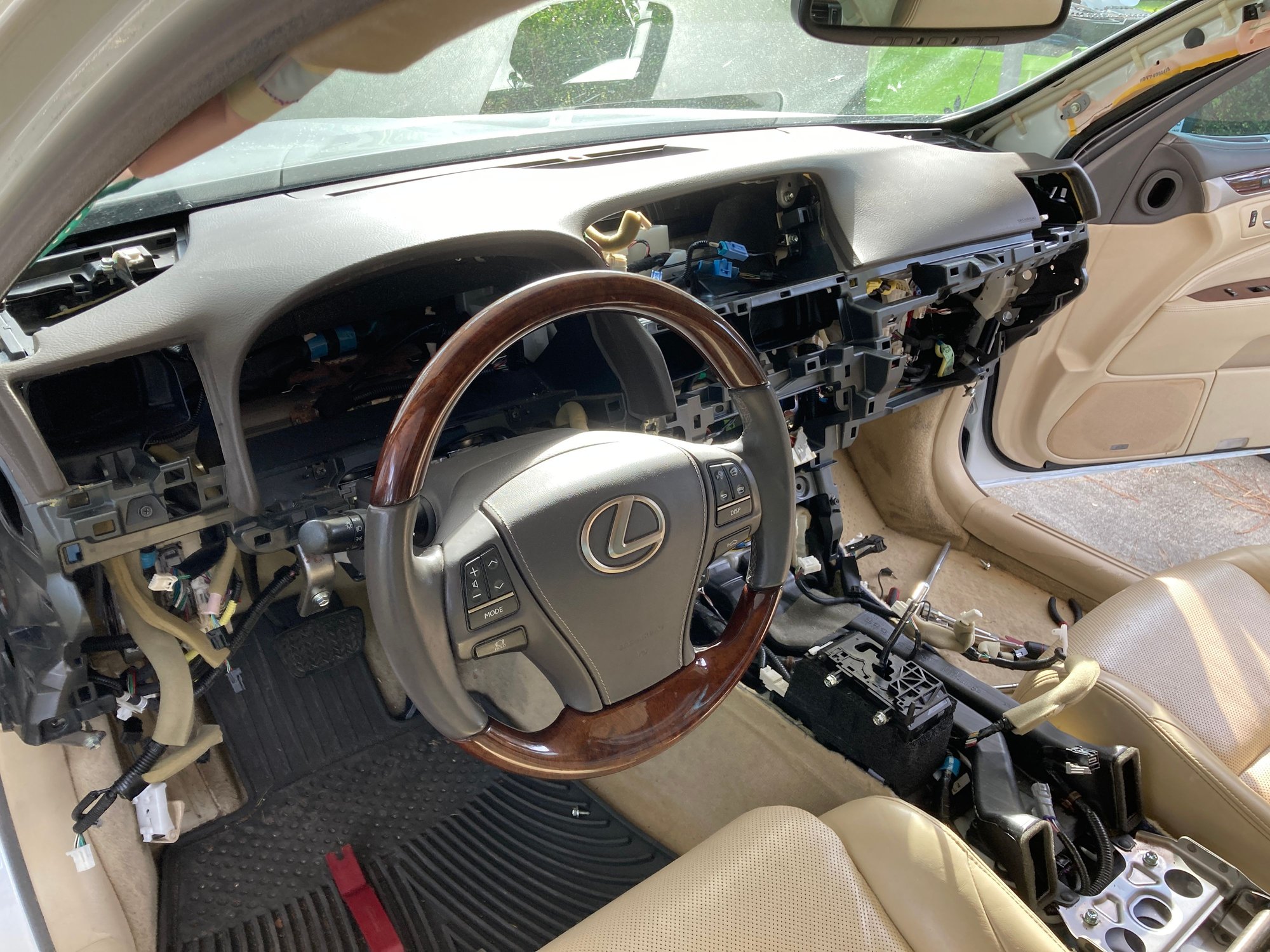

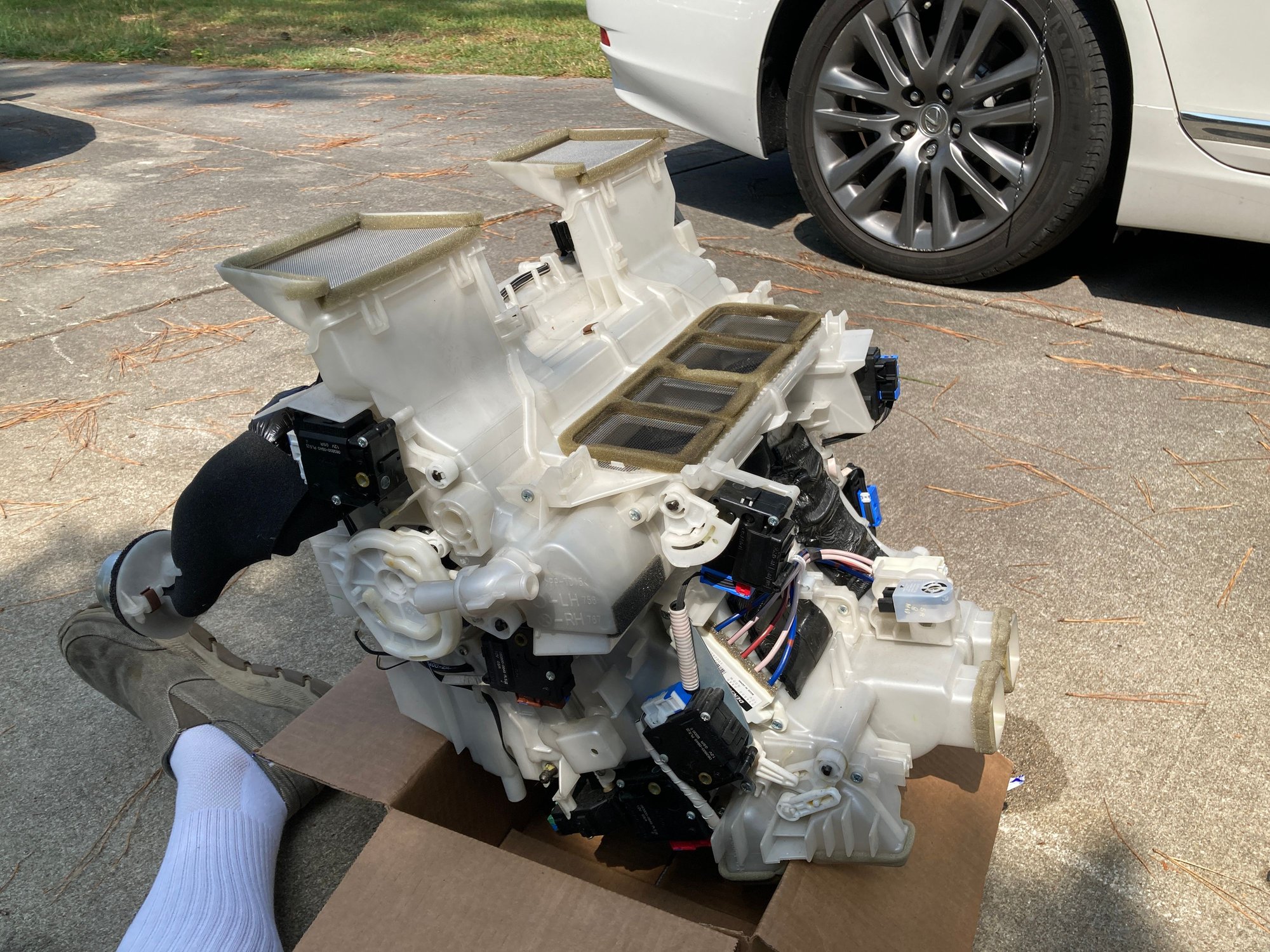

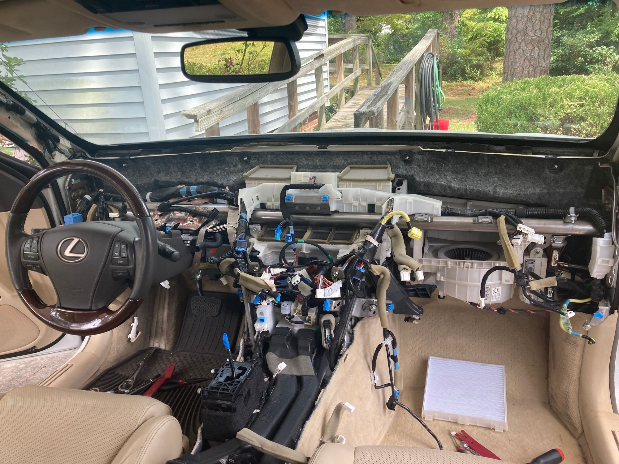

Welp... after a few weekends of work humpty dumpty is back together again... Pulled the evap core out. Turns out it looked fine. Maybe the O-rings were shot. Hard to know. I did replace the condenser while I was in there. Did a vacuum test and help the same pressure for 24-hrs so I'm happy. Got the AC recharged by a local shop today so I'm ahppy. Some pictures of the whole process. Overall the most difficult part is pulling the crash bar out. It's tied to the AC/Heater core so don't detach one from the other in the car. Also there's 1 wire that goes to the back of the condenser core you can't remove when it's all installed. So your stuck trying to hobble out the crash bar + AC/Heater core with the main harness still attached. You need two people for that part. Also keep the blower motor assy and AC/Heater core together. No need to separate them.
