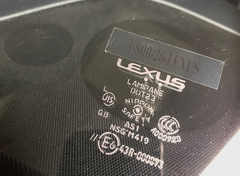

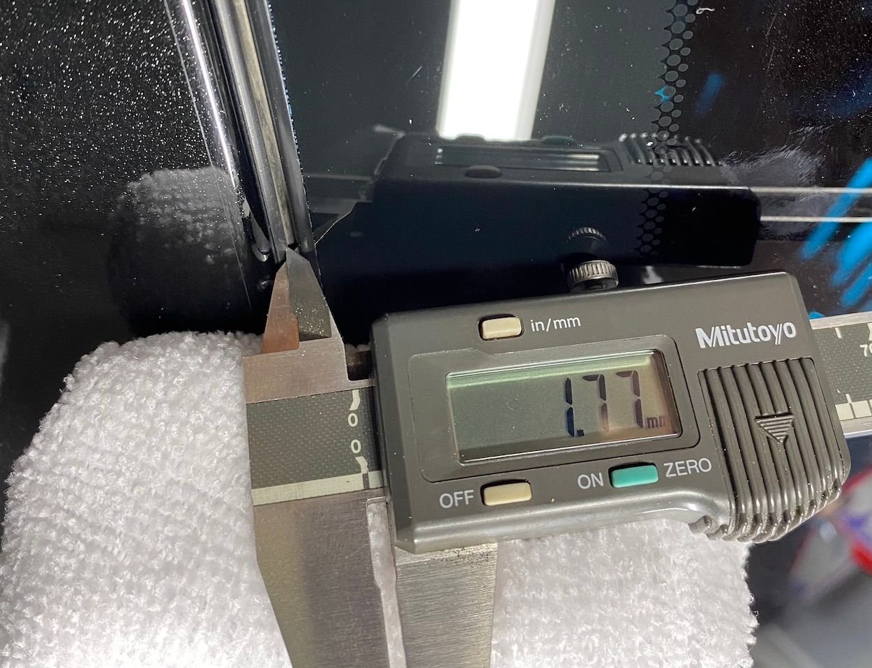

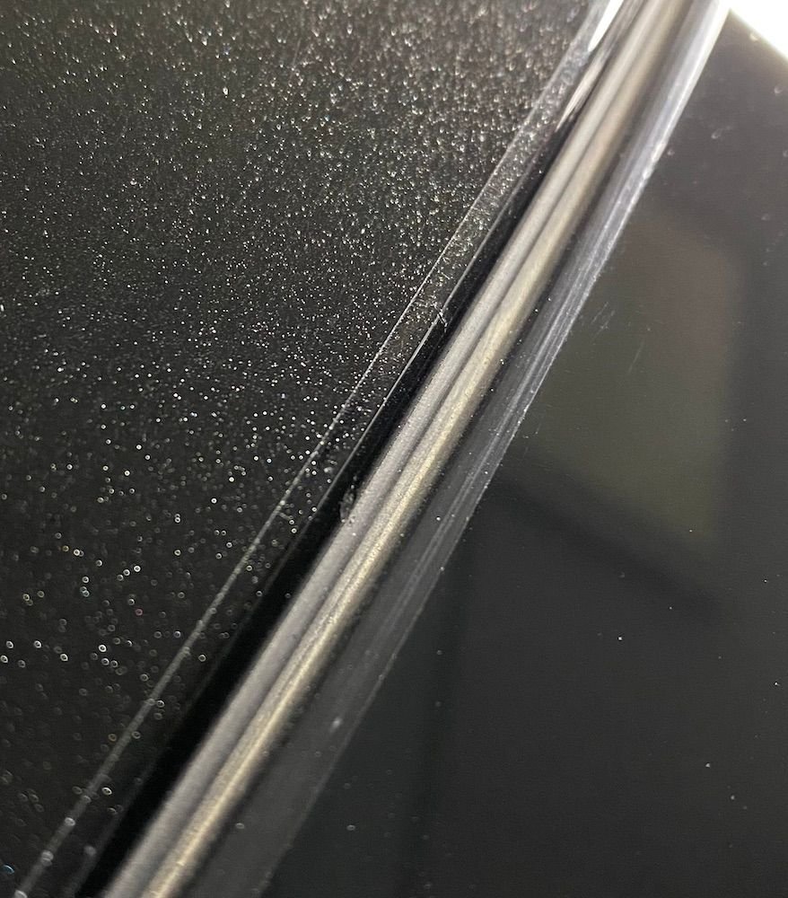

Well they do a good job installing glass, I've never had luck getting windshields replaced... something is always not as it was.
My 13 has the original w/shield and aside from some light sandblasting in a few spots it's good and I hope to never replace it.
This is the upper area where the roof meets the glass, it sits on a rubber seal and no adhesive is visible. I'd be willing to bet this area would be filled with black goo after replacement.
It's not as wide as it looks.
My window sticker
Just too many things to get screwed up on what seems like a simple job.
