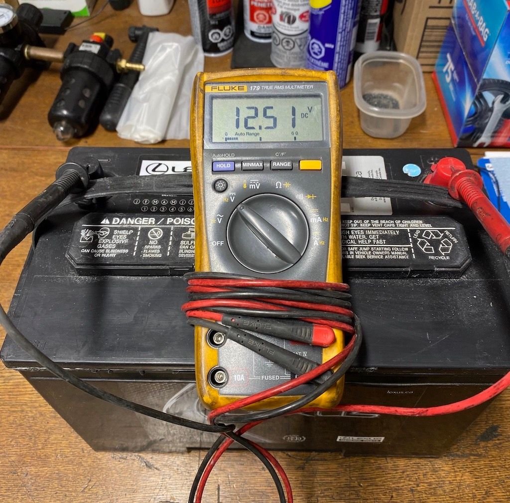

Hey all,
So, started running into bugs in my 2014 LS. Tire pressure monitor would not show any values and sometimes not even respond (yellow icon on the dash sometimes), when listening to audio via AUX, it will sometimes show "Radio Off' and the clock, no matter what I do, once I shut of the car, it loses time, it is never correct. When I got the car, the clock was fine, always was accurate, so this is new.
I checked the battery in the car, it was the original battery from when the car was new(I checked histry). It was .5 lower than it should and according to what I read, that would cause these gremlins. The car was starting fine, and time was not easy, so I lived with it for like 2-3 weeks. No problems starting the car at any point.
I was Walmart for something for my wife, and they had a battery that is in range (looked up specs to make sure). I grabbed it put it in and drove it for 2-3 days and noticed no change, all the gremlins are there. I figured, cheap battery, better not trust it.
I went to AutoZone and grabbed a Duralast Gold ( BCI Group Size 27 810 CCA 27-DLG) battery, it was not the entry level battery in the shop. All with specs for the LS, some gremlins are gone but, clock is still never right, radio showing "Radio Off" still shows it's head.
Do I need a higher end battery than a $300 Duralast Gold? Or did a damage things by driving it for 2-3 weeks?

Ok, so I checked the battery (voltage is good)..... I pulled off thermals, they were a little dirty but, nothing I would worry about. I sanded them down (both sides), so I could see them perfectly clean, reconnected, made sure they were very tight(with tools). No change.
I used TechSteam, I checked the Navigation system in it, and it said the clock was disconnected with a B code (forget exactly what the number was, B codes are factory codes). I cleared all the codes, re-stared the car and reconnected the codes didn't come back.
STILL the clock is not accurate. IT WAS PERFECT before the battery got low. ANY idea on how to fix this? I really do not want to dump a ton of cash into this with a guessing game. Is it the clock, or the radio, etc?
