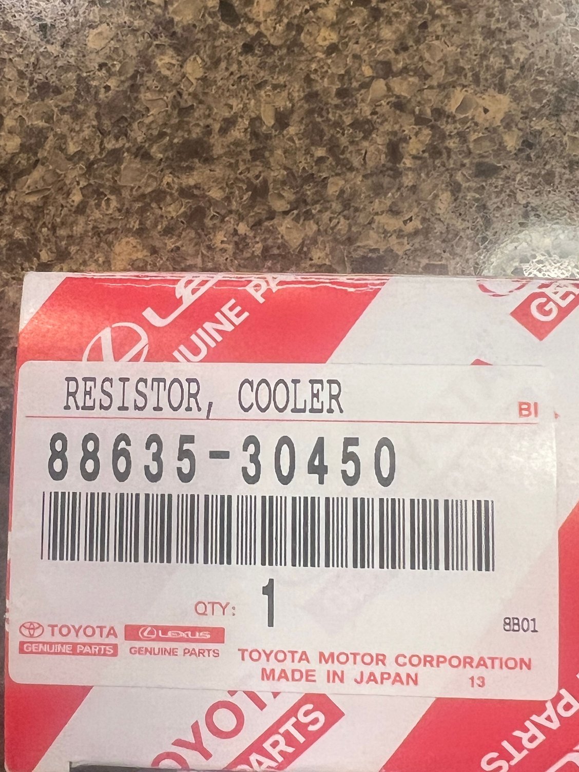

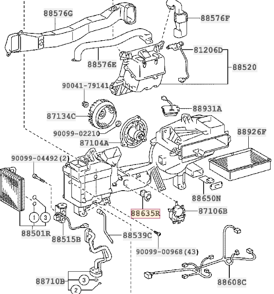

Hi all,Bought a blower resistor for my 05. Symptom is when the car heats up and fan kicks to low, in winter, you can feel the car becoming cold again. Had a similar issue with my S 10 and the resistor is an easy swap. Can’t seem to locate the resistor on the parts diagram or if it’s part of the blower subassembly? Has anyone changed out a resistor if the motor is a little weak on the low setting?
for comparison, my 04 never had this type of issue, so I know there’s something either not electronically right or not mechanically working correctly.

This is for a JDM RHD Celsior but I'm sure you can guess where it is on your LHD LS430.
