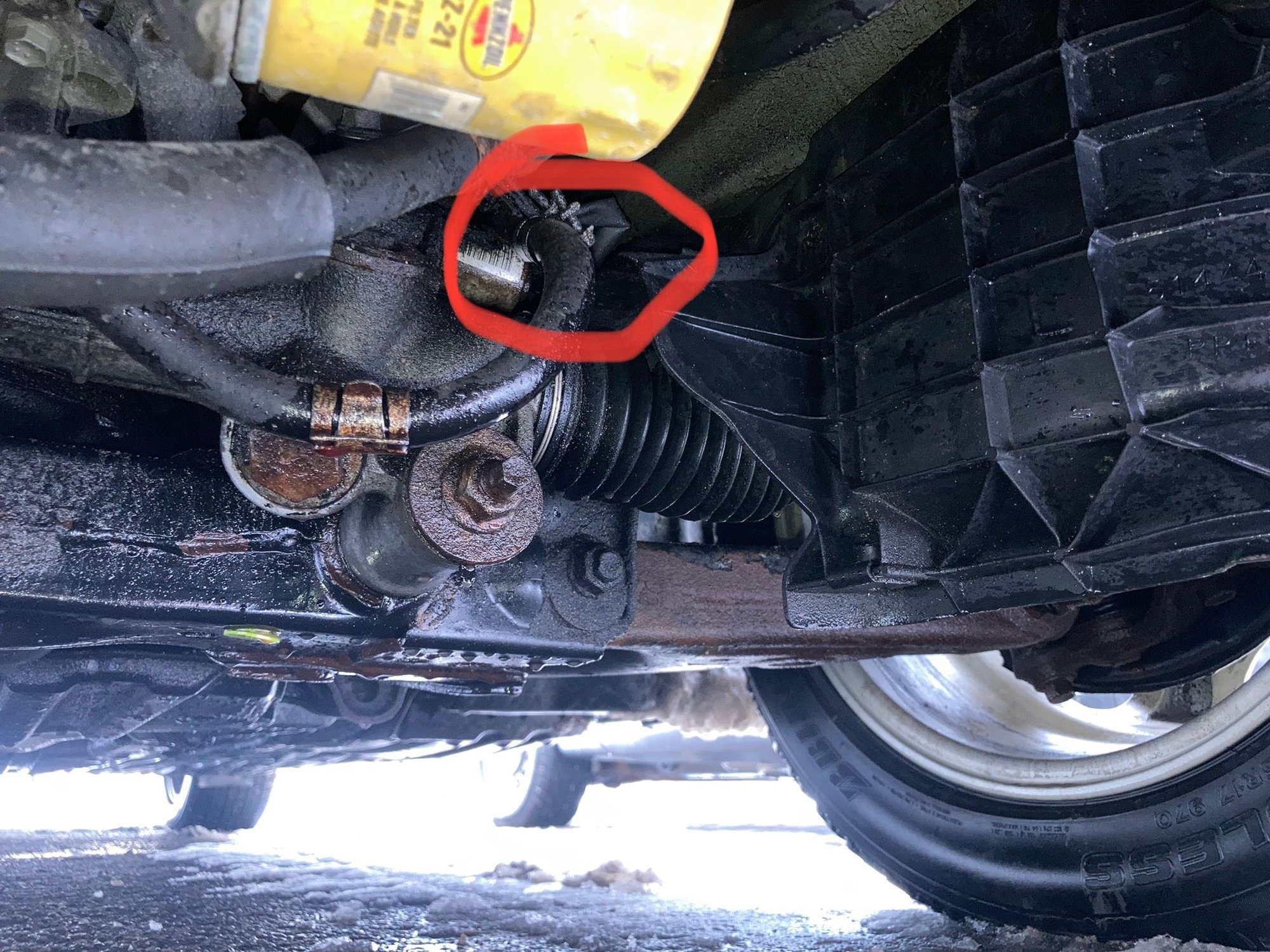

Hey guys first post here.

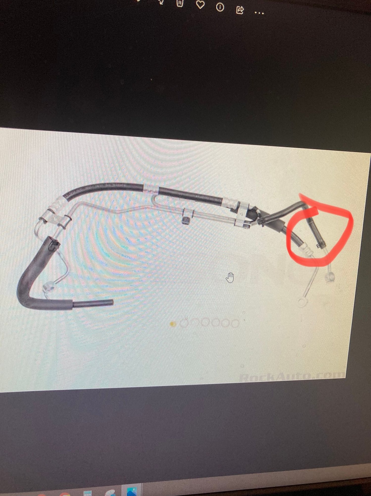

I got an 03' LS430 with about 220K on it. Just recently noticed a power steering leak coming from the return line that goes from the rack to the pump. It is leaking where the rubber lines clamps onto the metal line at the rack. I replaced the rubber line with a new high pressure hydraulic line and used new fuel injection clamps but it still leaks pretty good. Was wondering if anyone has had this issue or knows any tips to getting it to stop. I really don't want to spend $250 for the whole line assembly when it's just this 7 inch rubber piece, but if I have to I have to. Will try and post pictures. Appreciate any responses.
Thanks guys.
