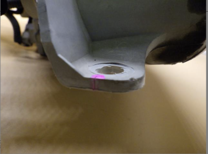

Hi, I live in Australia too so I feel your pain with availability and prices of parts here. Years ago on my 2004 LS430 I had the same issue. I managed to source a set of new front lenses only from Japan. Unfortunately the shop I bought them from no longer exists. There wasnt a part number. I did have to use a japanese buying service because they wouldnt deal with anyone from outside japan, but it was easy and the items were shipped to me.
Removing the headlight requires loosening of the front bumper on the sides to enable access to all the mounting bolts. Many used headlight housing tabs are broken at the bottom because people just undo the visible top bolt and think thats it. They cant see the bottom bolt and they try to force it out breaking the tab.
After removing the headlight I thought I'd have to bake it in the oven on low heat to soften the glue but I was amazed that simply heating the factory seal with a hair dryer slowly did the trick and it pulled apart easily. I couldnt reuse the factory glue, it was too broken up.
I bought some thick black butyl tape/roll from a glazier supply company and it fitted in nicely and created a great seal. The lights look great again without having to replace everything. Never had any leaks. Have a look at some Japanese sites and see if you can find some lenses only.
I think that part number is 81171-50260. I had it in my Megazip cart for a while, just never ended up purchasing it. I have a feeling the ballast in this current headlight does not have much life in it, due to all of the moisture that has been inside over the years, which makes me want to find a decent condition used headlight. If the search goes no where, then I will most definitely go that route of new lens and new sealant etc.
