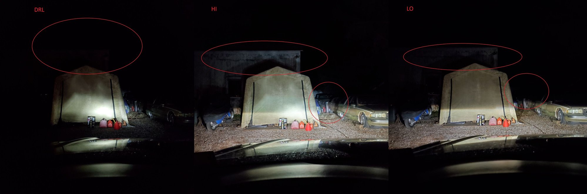

Is there a difference in brightness between the drl and high beam? In the pictures the brightness looks the same.

I circled the areas for comparison.
I used a fixed exposure for all settings.
Would say its about 50 vs 100% brightness.
