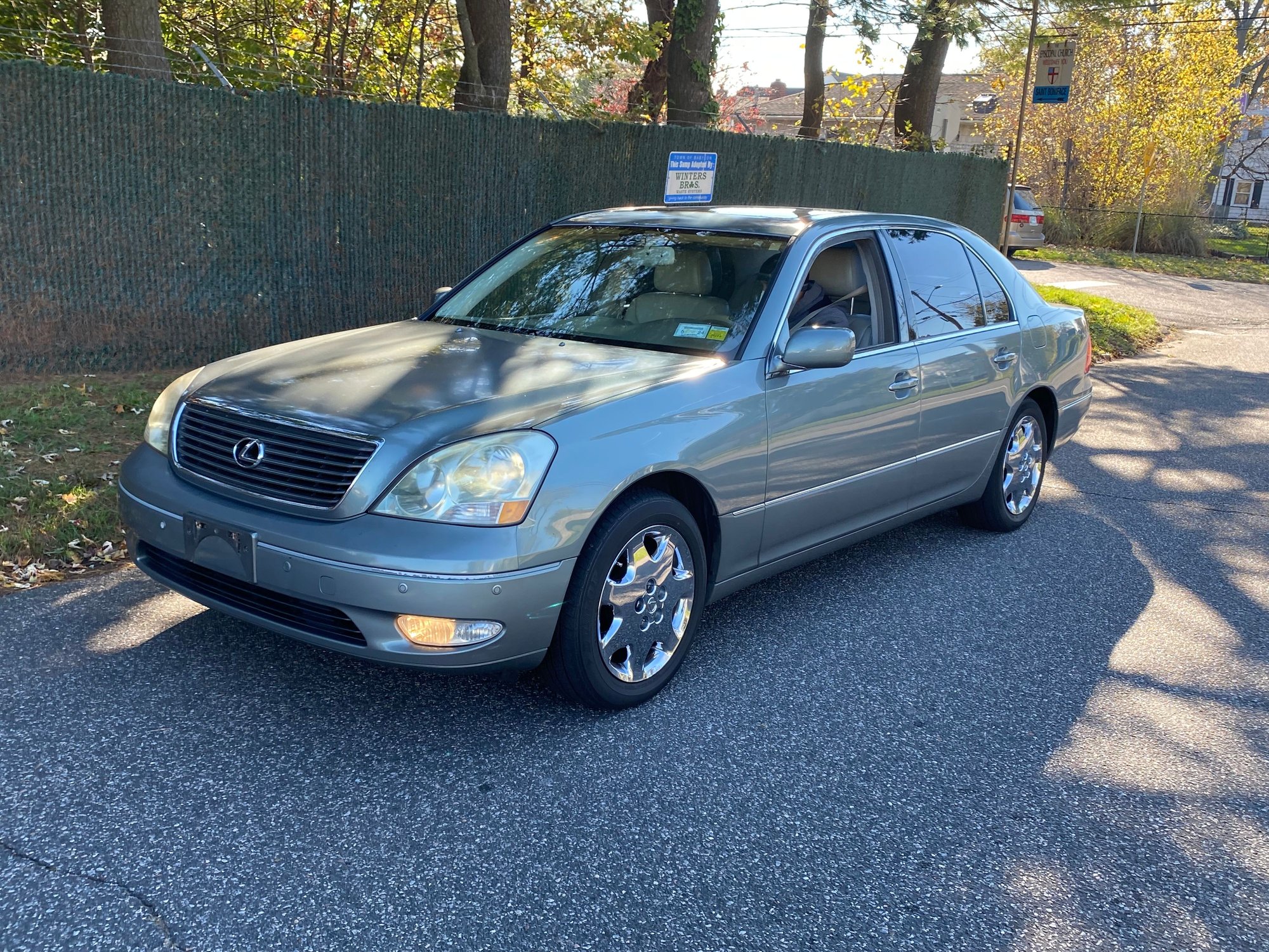

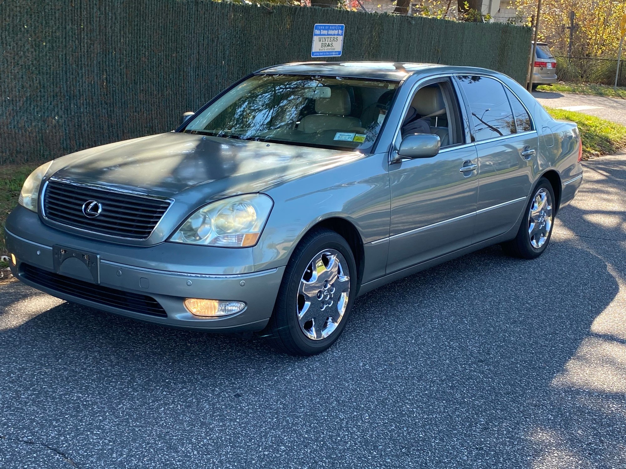

After many years of trying to get a LS and being unsuccessful every time, I finally got one today am so excited and looking forward to making a clean and simple Cruiser. Thank God. As for now it has almost 125k miles, the mirrors don’t work properly and the tilt Motor needs to be replaced. and the VSC light is on. The good part is it’s pretty clean I love the color. I want to upgrade the stock tails to 04-06 LED tails… and get a roof wing for now.
I don’t think I will be Lowering it just need a set of wheels as I will be keeping the stock wheels.. I plan on keeping this car for a long time.

Wow, love the color. it looks very clean. i keeping an eye out for one myself. May I ask how much you paid for it?

I love the color too it just grows on you, it’s different rather than the navy blue black or grey. Silver spruce has been around for a while since the 92 Lexus SC originally I believe. Good luck on getting one hope you do soon.

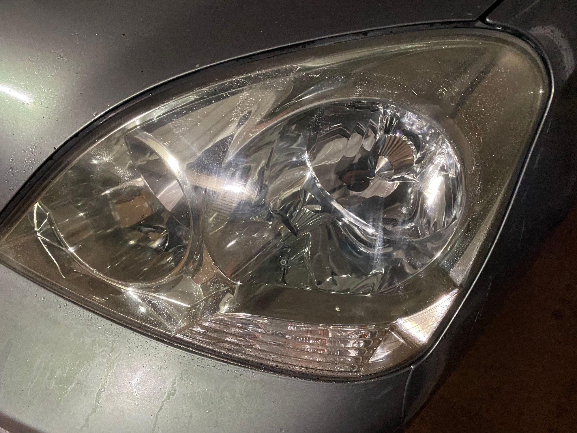

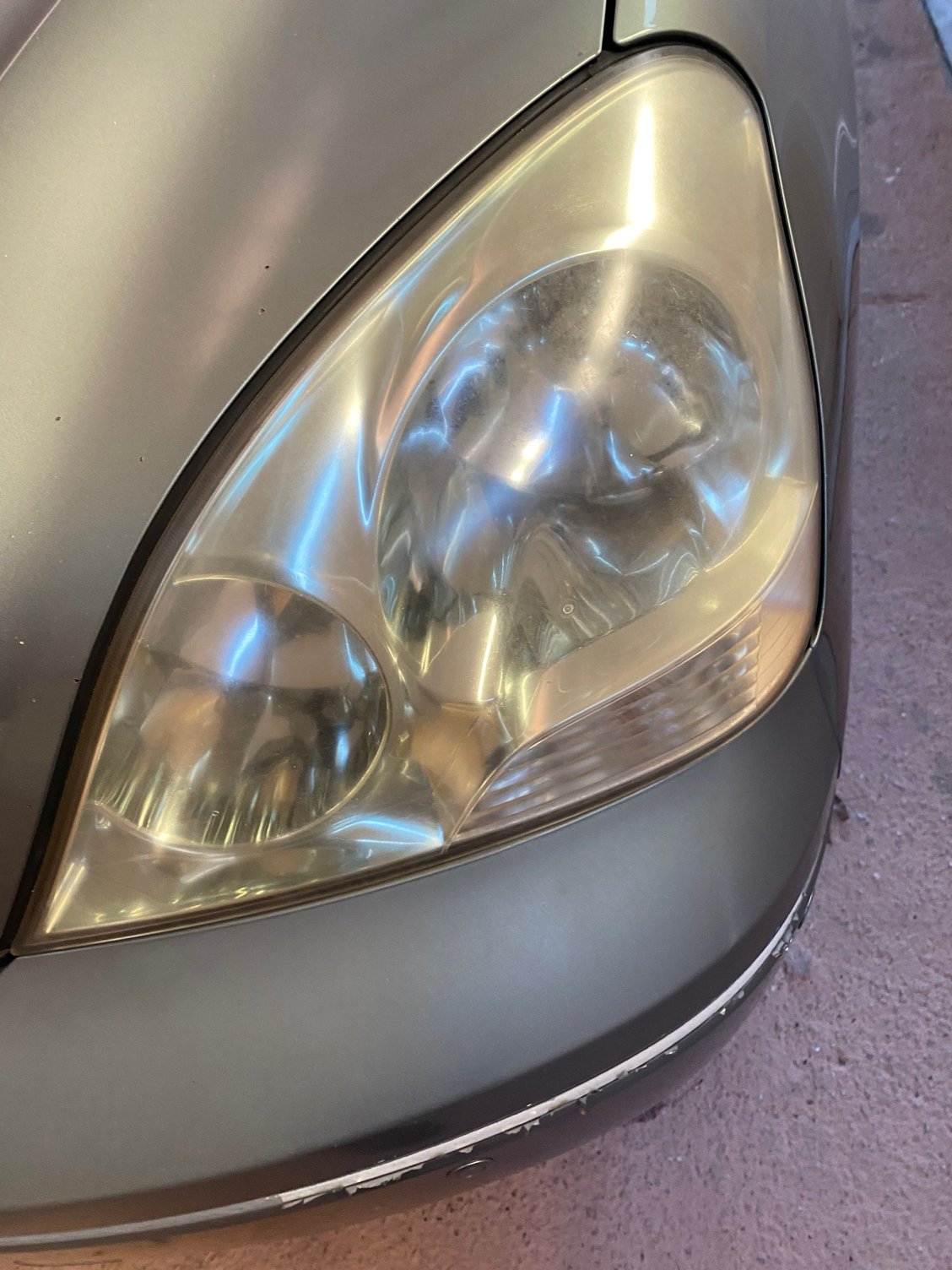

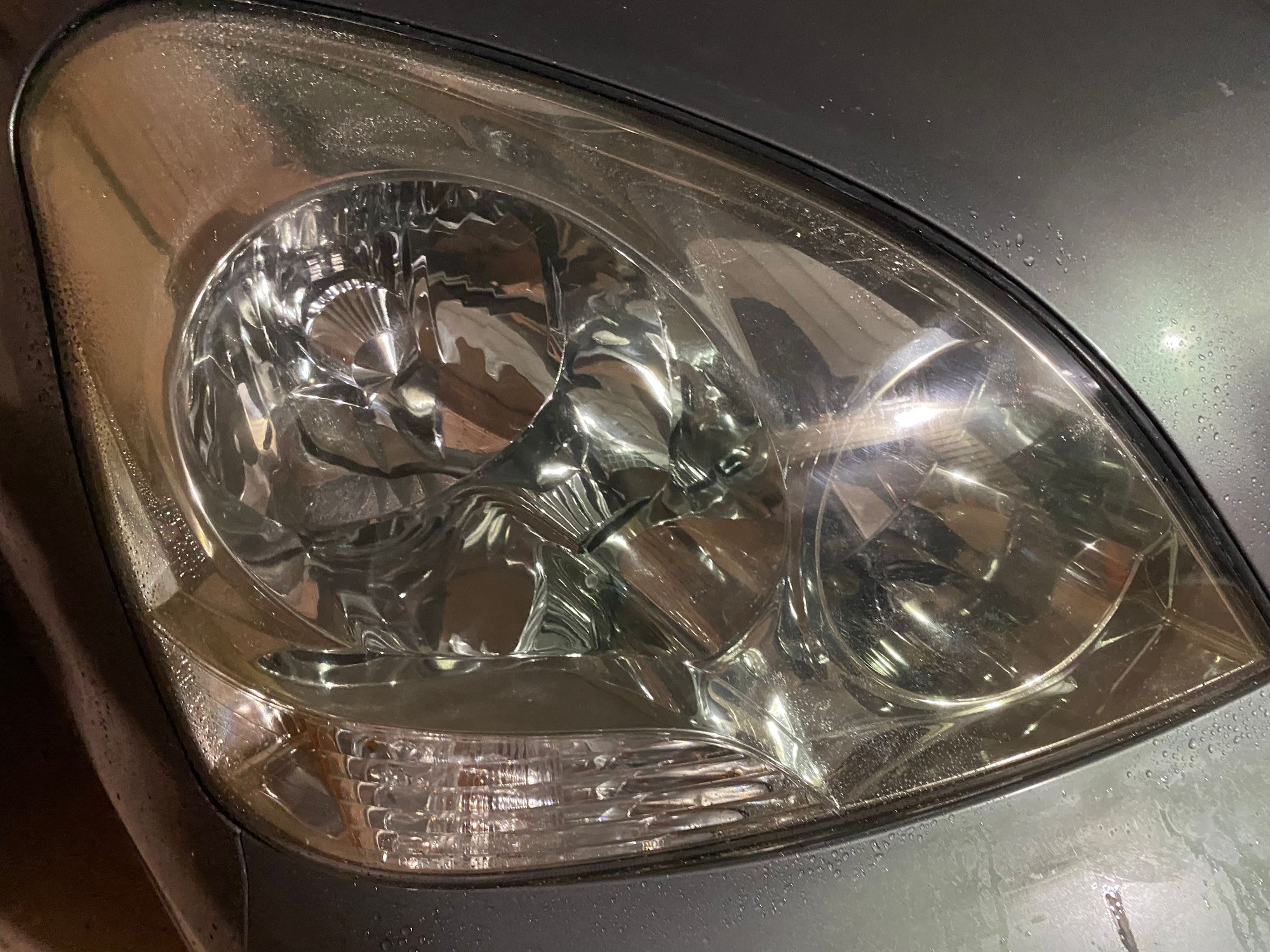

Before
I need to refinish these lights
After results but there seems to be fine scratches on the light and it irks me , how can I remove it just wet sand ? The scratches are visible and looks bad up close.

. I’ve used a mobile service for years that comes to the house, wet sands, and then sprays with a clear. Headlights looked new and warranties the job. I had him come back after 6 years of constant sun on my mom’s Honda and he did a do over for $35. My LS is still holding up for many years. Most kits are temporary.

I did mine 2 years ago with the 3M kit. Worked well and regular re-application of the final wipe has kept them clear.
Difficult to say with yours from those pics as the spray hides the scratches but if you can still see scratches then you need to keep sanding.
Mine took about an hour of sanding with the drill attachment. You also need to keep cleaning the surface to prevent further scratches and always make certain that the surface is wet.
If you get impatient you just introduce new scratches.
