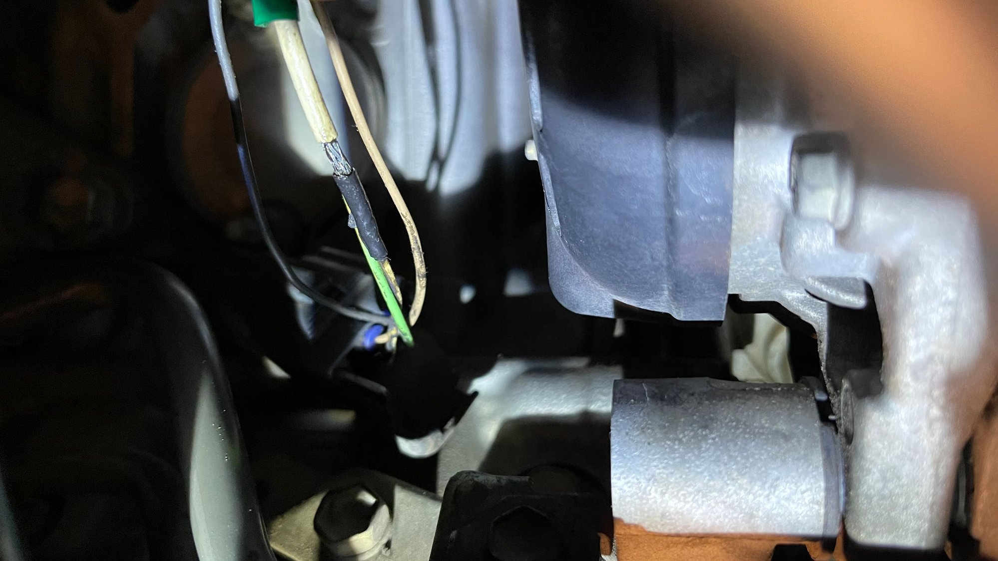

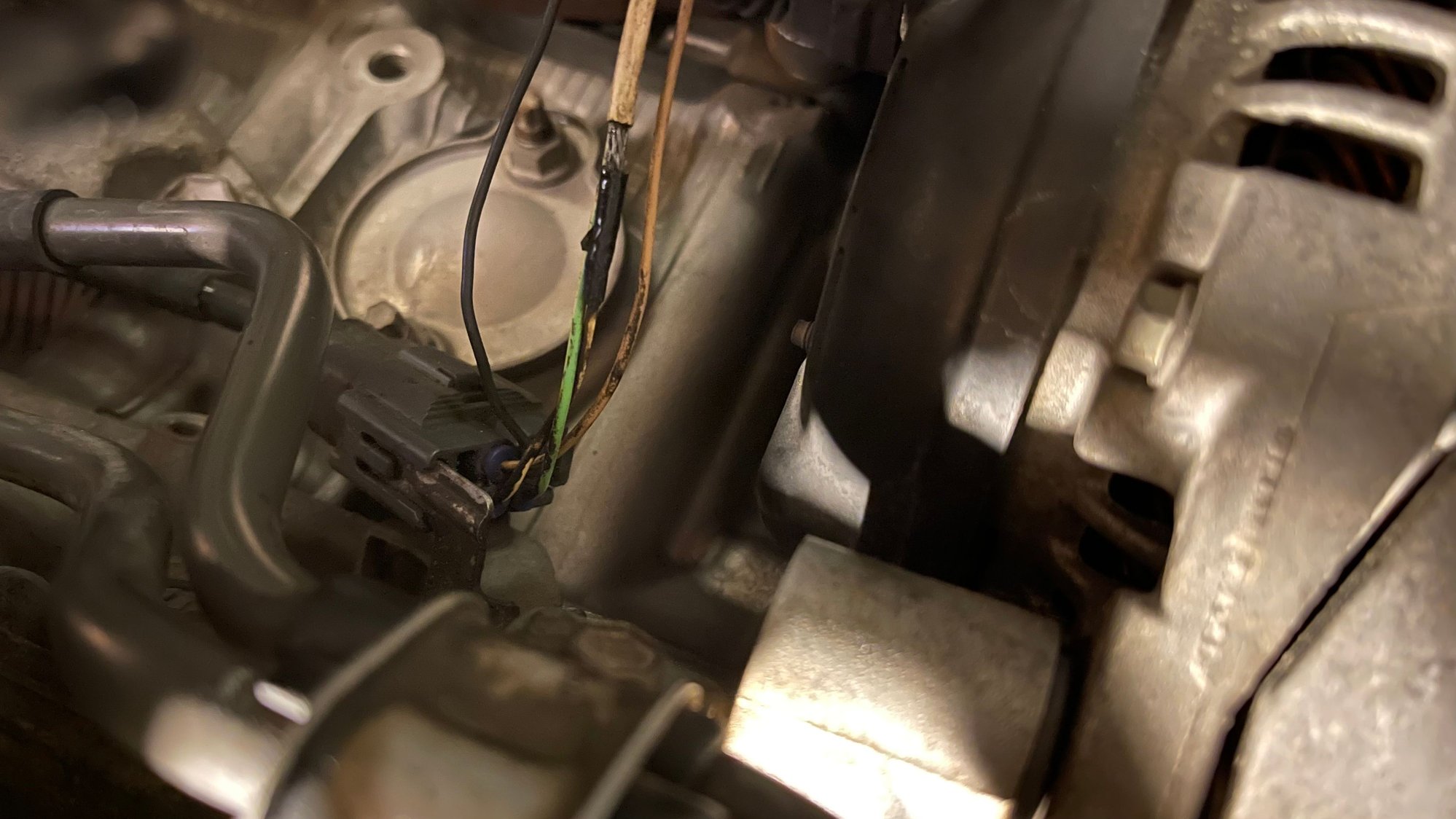

Yea, I did charge on the CC and submitted the dispute. I crawled up under the car today and looked around. Nothing looks damaged. I paid them to replace the oil pan gasket and I am not convinced that was done. While looking around I did notice this wire that is exposed. It seems to go to the transmission and goes to bottom right input of the plug.
Anyone know what this plug is or does? Im wondering if this could be causing my engine light to come on?
Located on the passenger side of the vehicle under the power steering reservoir.
