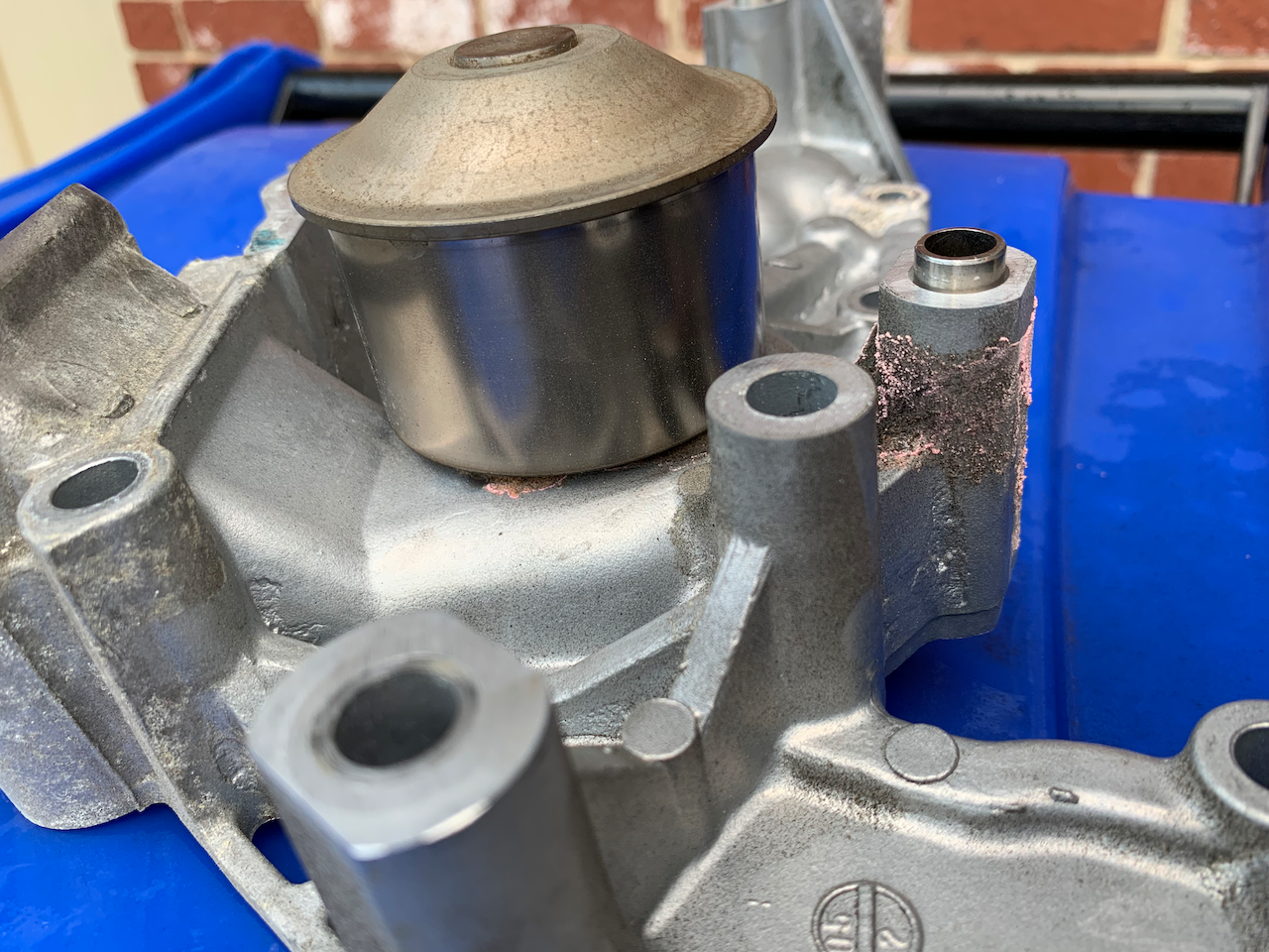

My 2005 LS430 had its first timing belt/WP replacement done today, along with radiator hoses, thermostat, idlers, tensioners etc (it was a Gates kit). The car has 74,100 miles on it currently and the parts pulled off are pictured below.
Coolant was starting to leak, finally after 17 years

I wouldn't use gates on these cars....use OE or Aisin only
I found out 12 years ago that my timing belt was changed with a Gates timing belt prior to my purchase at 98,000 miles. 159,000 miles today and 12 years later with my Gates belt and original water pump. Knock on wood!!!
I tried to find information online of any instance of the Gates kit failing, wholly or partially, and came up with nothing. If there is data to support that Gates’ supplied pumps and belts are prone to failure, please share with me (or the forum) for future reference. Thanks!
note: I would’ve preferred OE parts but my trusted mechanic wouldn’t warranty the work unless he supplied the parts. Toyota said the same thing, but their kit was some hodgepodge from O’reillys. The service manager at my local Toyota house said if I provided the OE parts, he would install them but again, wouldn’t warranty the work. In the end I chose the indie because he was offering a known brand (gates) and it came with a warranty.
