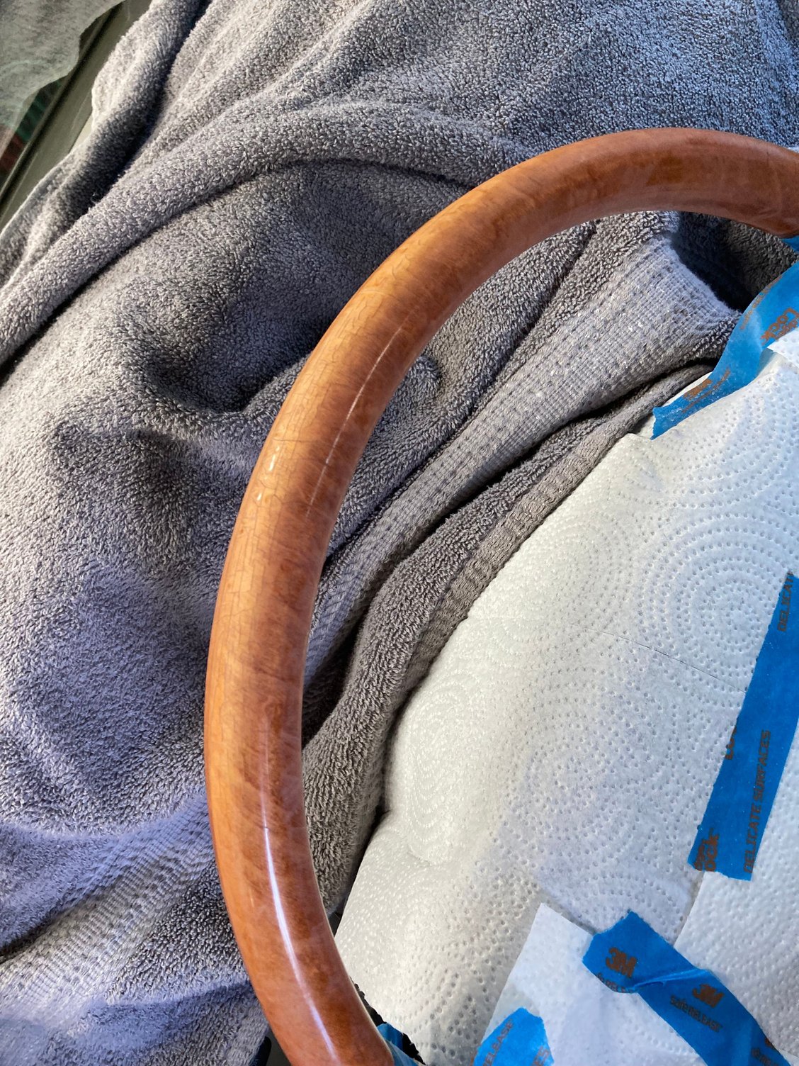

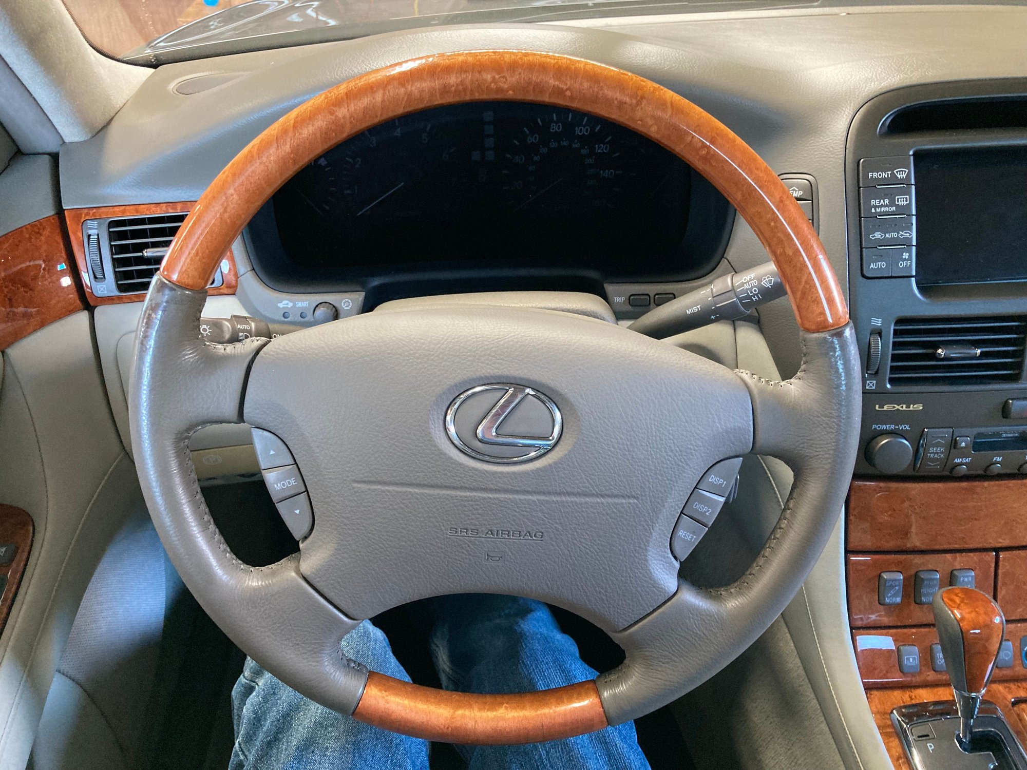

As with many LS430’s the wooden part of the steering wheel develops cracks. I refinished mine so the cracks are less visible and the surface is now nice and smooth. Here is how I repaired it in place.
Here is the original wheel…..
First step is mask off the leather and place towel behind and below the wheel.

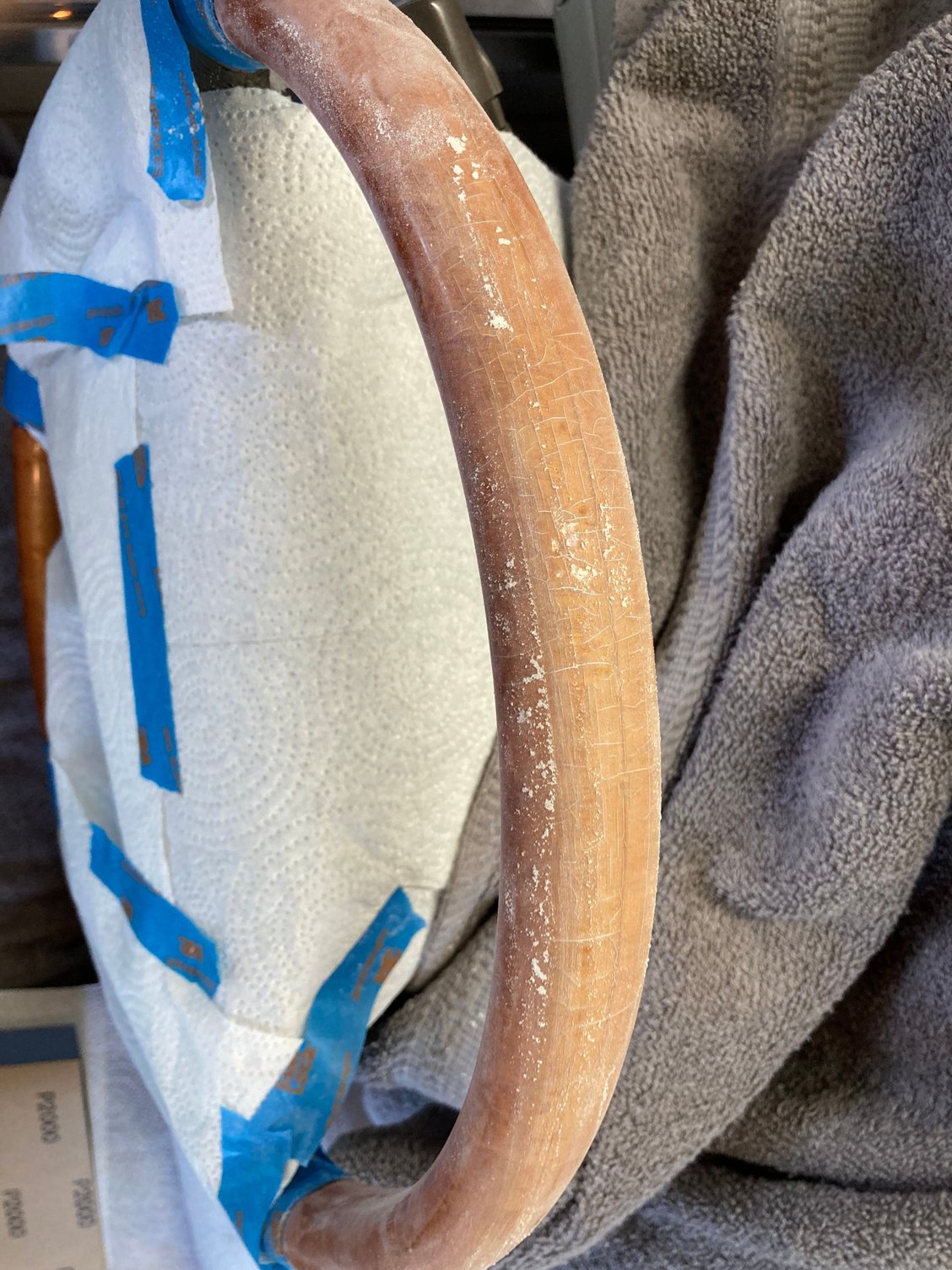

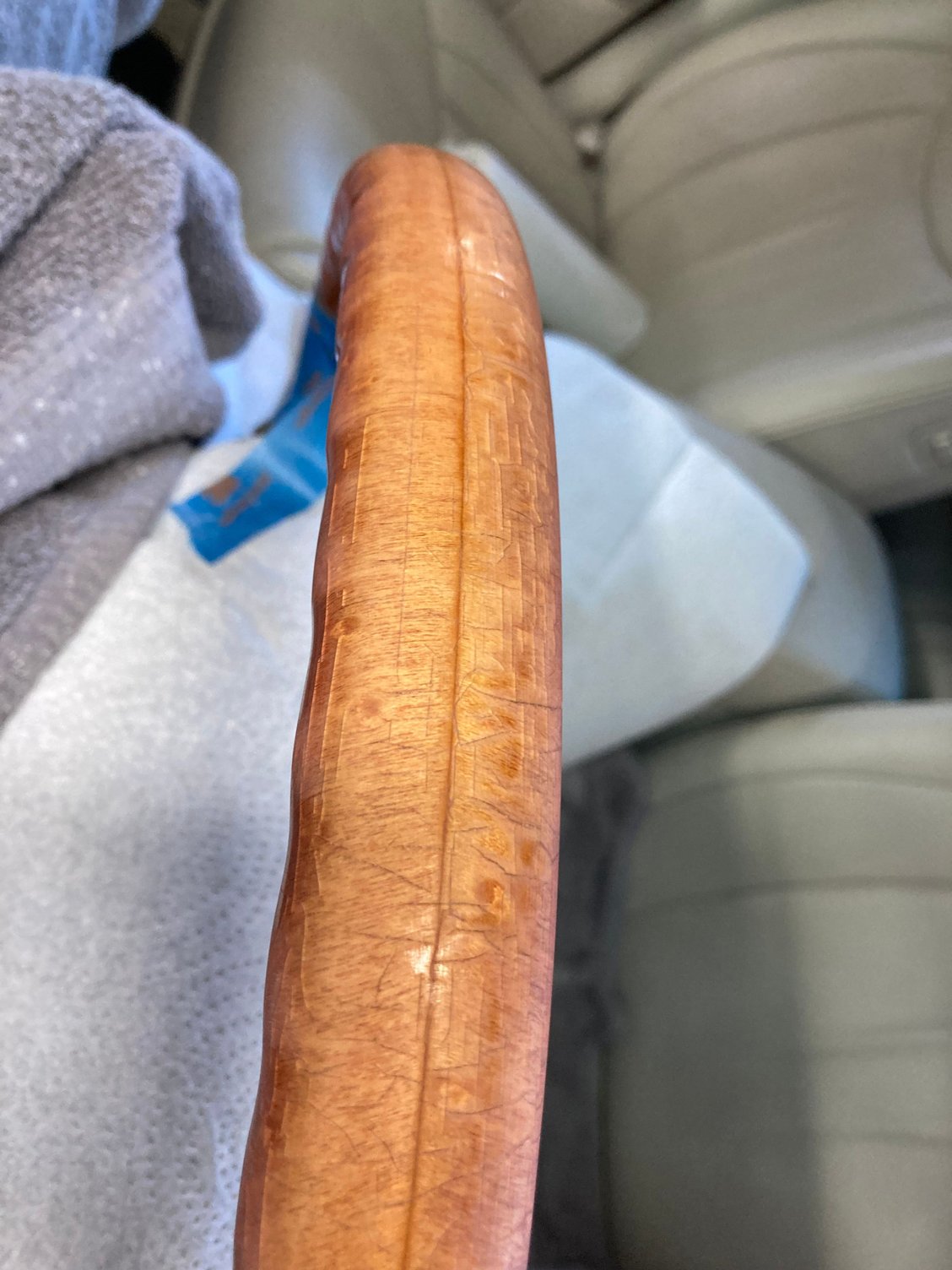

Next sand down with around 330 grit paper just until the cracks feels smooth.
Clean surface with alcohol and clean rag
Next apply thin coat of water base Minwax wipe on poly. ( bought at Lowes) I applied with piece of cotton tee shirt. This stuff is great because you wipe on. No brush marks or drips.
allow to dry for 4 hours than lightly sand with 3000 grit paper. Wipe clean with rag. Repeat coating every 4 hours for 4 coats.
I didn’t sand between these coats. After last coat has dried remove masking tape.
Here is the finished product. You can still see much of the cracks but the wheel is nice and smooth since the cracks are filled in and
covered with the poly.
My last LS I put on 10 coats but that was overkill.
