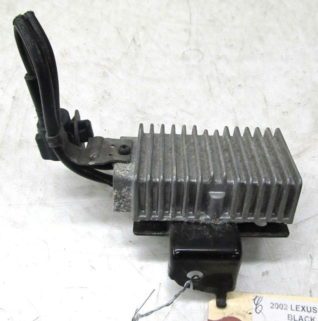

This is what the fuel pump resistor looks like. It has two pins.
Just disconnect the resistor and bridge the circuit of the connector pins on the car side of the plug with a bit of wire (or something more professional if desired) It's just to rule it out. When I have checked mine, I just used a short length of old wire of a similar guage which had a couple of connectors crimped on that I had lying about. I taped it over to make sure it would fall out during the test. My resistor and pump was fine so put it back to original after the test.
