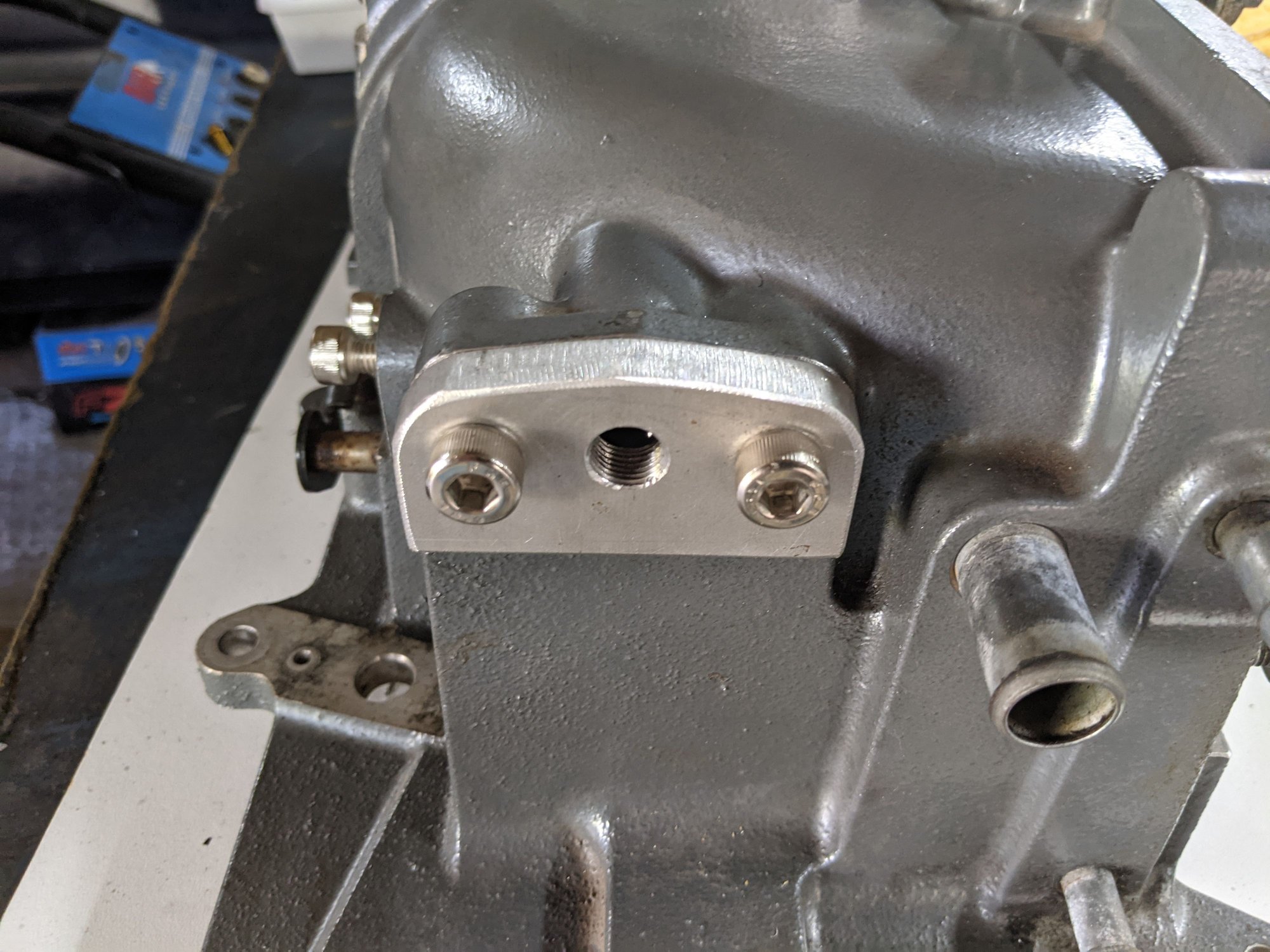

Not breathing too well today so used some time to make up a blanking plate .
I included a 12 x 1.25 thread to take the factory banjo bolt and fitting for the feed to the brake booster .
You can see I did it a bit different to Safd .
I used a stainless double banjo bolt on the inlet side with an AN6 banjo fitting and a single S/S banjo bolt on the other side with the same fitting .
I used a 90 an-6 on the inlet side and a 45 an-6 on the other side as the pic's show .
I like that I only have one hose and was able to leave the Lexus hose alone .
I just cut the pipe off a bit from the factory inlet banjo and then welded it over .
