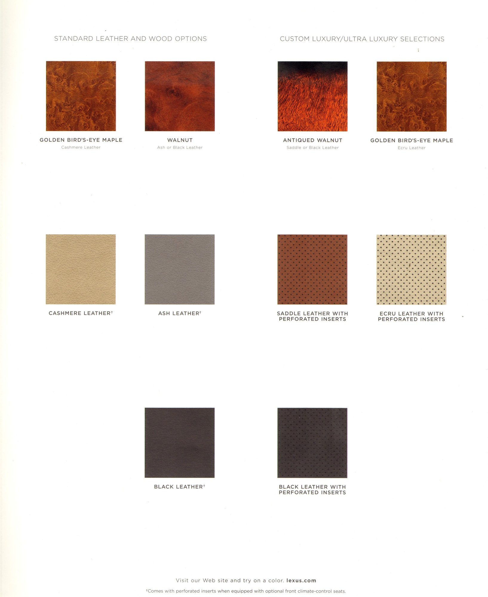

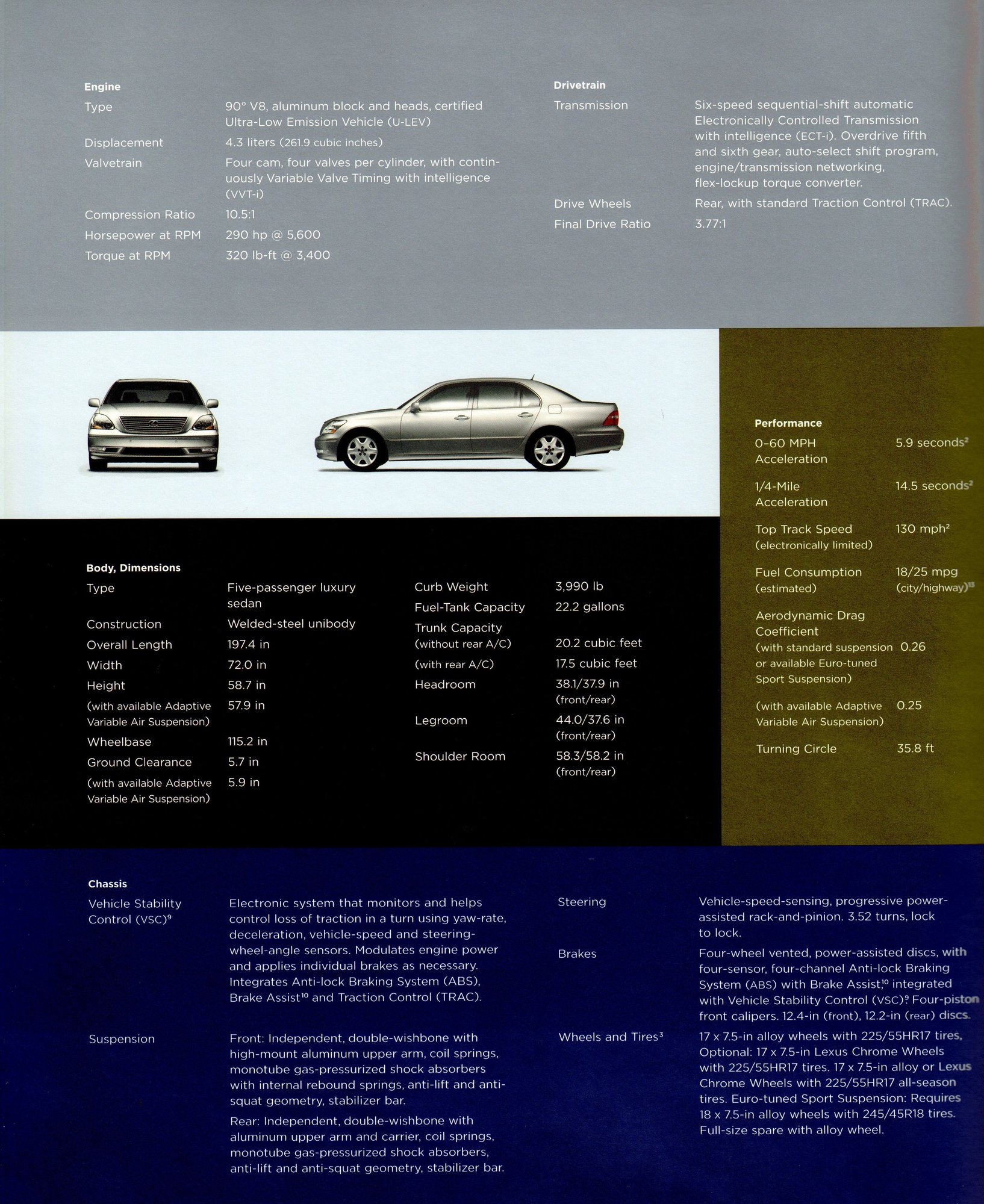

Good to know it is just like body work cause that is how I have approached it. The stuff even dries quickly like bondo. I have applied a few thin layers and it is starting to looks really nice. I’m excited to get the new color and test out the match. By the time that arrives I should be done with the repairs. I will most some photos when I get done. In the meantime, I did get my hands on the 2004 brochure. I included a few pages.

I just pulled the trigger today and ordered the Seat Doc kit - and used the VIN and gave it to seat doctors - Door Vin Tag says LA07 - seat doctors says cashmere - Looking at the color chart I say cashmere is the same situation as you - Will see how this goes - thx for the post -
