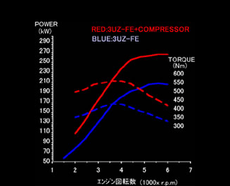

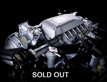

This is Tom's kit designed for Celsior (LS430):
https://www.tomsracing.co.jp/sv/prod....php?mprID=282
Excerpts:
Features
  • Features the latest low-friction Roots type compressor.
  • Weight-saving design due to the compressor unit replacing entire intake manifold.
  • Provides powerful acceleration even from low speeds.
  • Ultra quiet operation with conservative fuel efficiency, maintaining crisp  response at low load (during idle), complies with ECU controlled electromagnetic clutch.
  • Equipped with a water to air intercooler to effectively lower temperatures, resulting in ultra-reliable performance.
  • A catalyzer incorporated design in the front and center piping results in improved exhaust gas efficiency. (for Celsior & Soarer only)
  • Ease of installation. Includes everything from the compressor unit, piping, and custom computer for a completely bolt-on kit.
  • Reliable and long lasting due to its high quality. (Guaranteed for 1 year or 20,000 km)
Appears quality engineered turn-key solution.

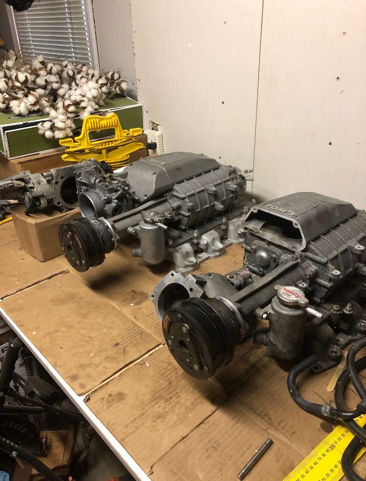

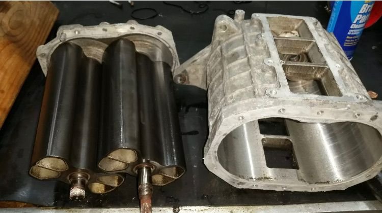

A few years ago I had two complete TOMs setups. They were decent for those looking for a modest but “reliable”, and I use that word loosely, bump in power. An Elate kit is overall a far superior being both modular and offering numerous replacement supercharger options, with a swap of the top plate, should something fail.
The TOMs choice of SC design was poor and the clutch actuated pulley unnecessarily complicated. Had they instead gone with a modern supercharger, utilizing a proper bypass-valve, granted an ECU/ load based controlled clutch pulley could have further reduced parasitic drag when boost wasn't requested. However the Ogura Clutch, Non-bypassed units, made the engine draw past the static lobes, which are fairly airtight, when the clutch is disengaged, that’s quite inefficient!
I will say the fully integrated Air-water IC in the compact intake manifold was a very good design, with separate heat exchangers and pumps to feed each bank. Bullet Cars AUS even used a TOMs casting as their blueprint to develop their latest low profile units.
Also look up “Kawasaki Jet Ski Supercharger failures” and you’ll see even more why those exact same Ogura units are failure prone. The pins that hold the lobes to the shaft have been known to migrate and permanently ruin both the lobes and the case or the lobes themselves have been known to deform, as in the last pic.
