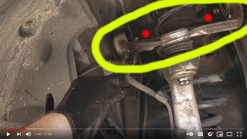

I'm good with the theory, but concerned about the execution. It seems like when the struts are in place, there's very little room (red dots) to get to the bolts so as to torque them. Also, is it even possible to do that when the wheel is on? Was your car on a lift?
I really appreciate the time and guidance!

If it's on a lift you can easily just use a trans jack/screw jack on the lower arm/ball joint area with a wood or preferably rubber block for safety (it will deform and prevent the arm from sliding around on metal) and then lift that corner of the car until it's off the lift arm just barely. That will show you where the arms like to sit under vehicle weight conditions, then you can mark them and then just move it by hand to the exact same location and tighten them. Or if you have access you can tighten everything as it sits when under load.
You can do similar on jackstands using a floor jack but be more careful.
