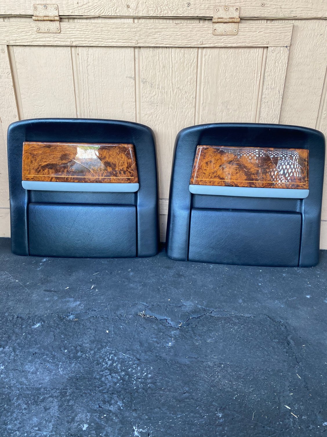

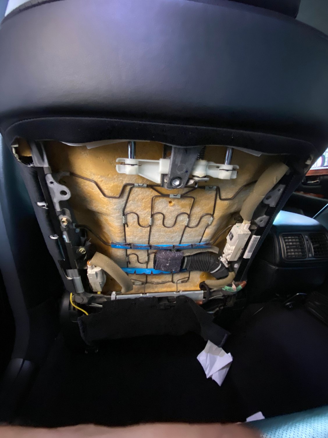

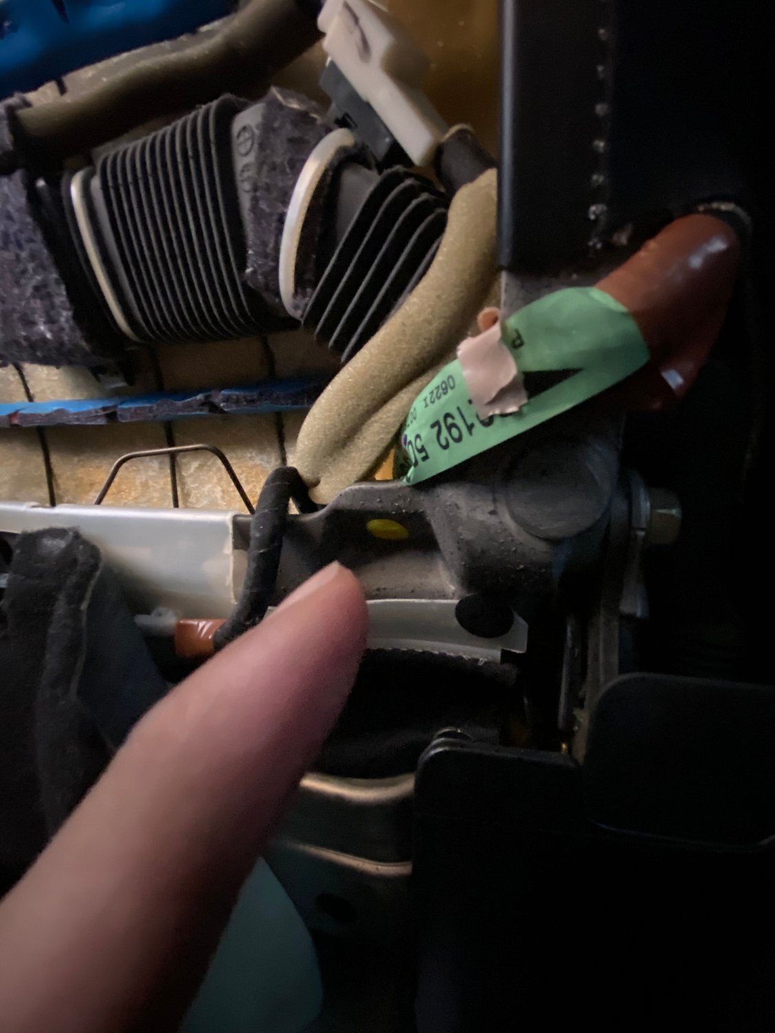

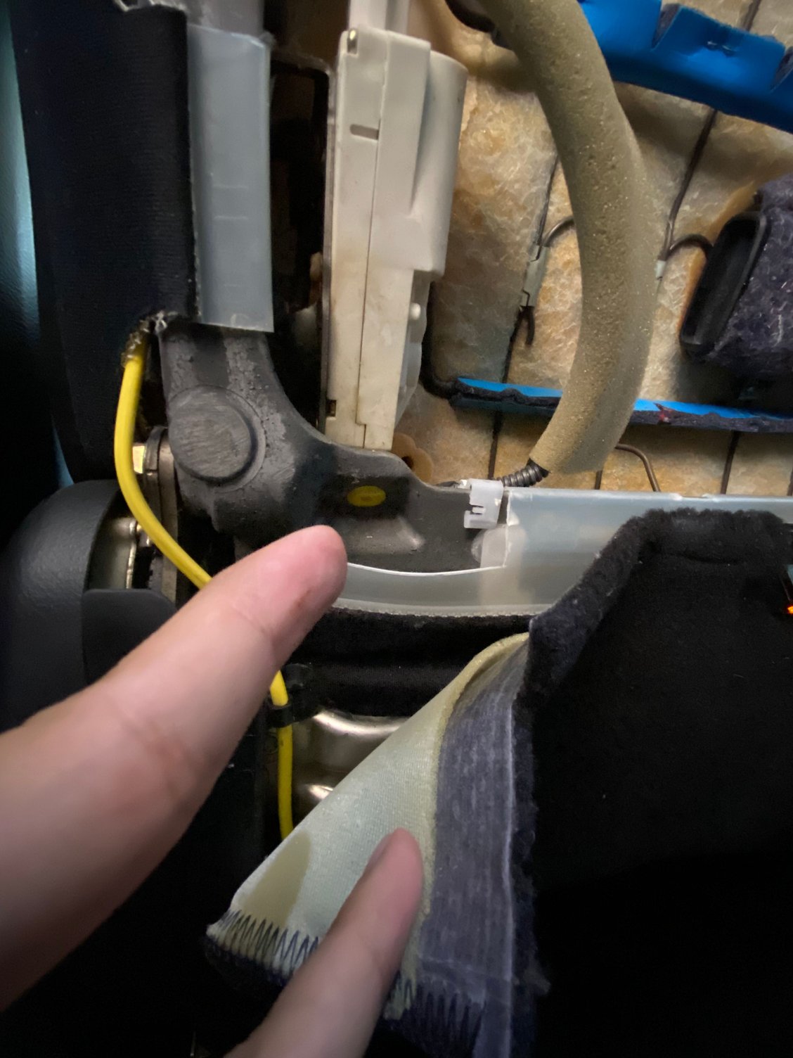

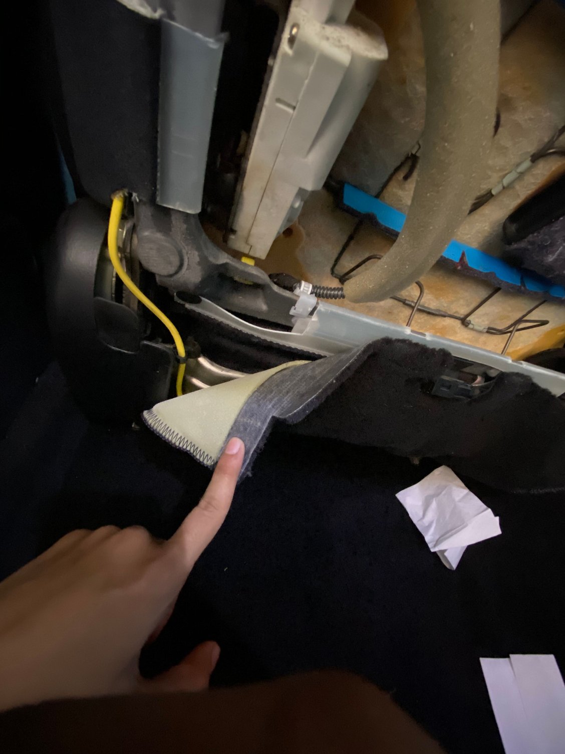

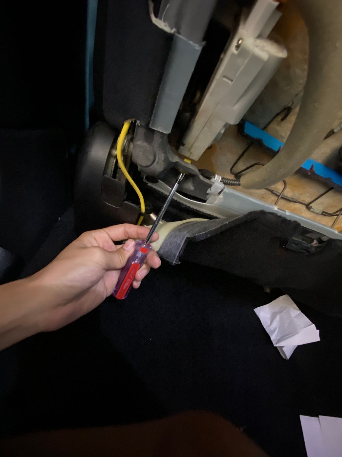

Move the carpet back like in this picture than you can access the 2 Screws at the bottom corners they have yellow plastic parts.
Messure to your liking and pre drill a small hole to get the screw started than make sure it’s leveled before you put in the second screw you can also use a bolt washer and nut for more strength
Last get a can of black fabric spray and delete the grey trim that will be on my next to do

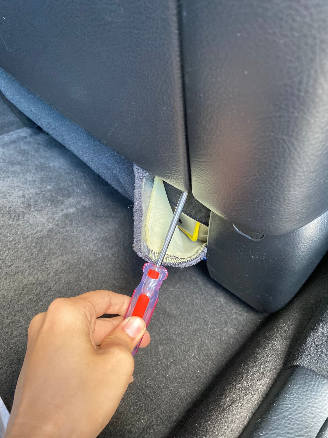

I am confused. First there are a lot of pictures of taking off the back of the seat then suddenly it shows the tables fastened to the outside of the back. What happened in between that picture where you are poking a screwdriver at the lower left of the inside of the seat to the next picture showing you fastening the tables to the OUTSIDE of the back.
Does the back come off? If it is already off, what are you pointing to and screw drivering?

There’s 2 holes for screws on the table On each side if you look at the picture with the tape measure, I drilled 1 small hole for the bottom screw, I tightened that in and made sure the other side was leveled before I drilled the bottom hole for the other side after that I went to drill both top holes. I took pic when I was finish with it my b I was to excited
I put the screw driver there so you can get an idea of where the 2 screws are holding the back of the chair intact so you can remove it

Taking those 2 screws off per side was no joke harder than mounting the table literally back breaking plus you have to put those 2 screws per side back
