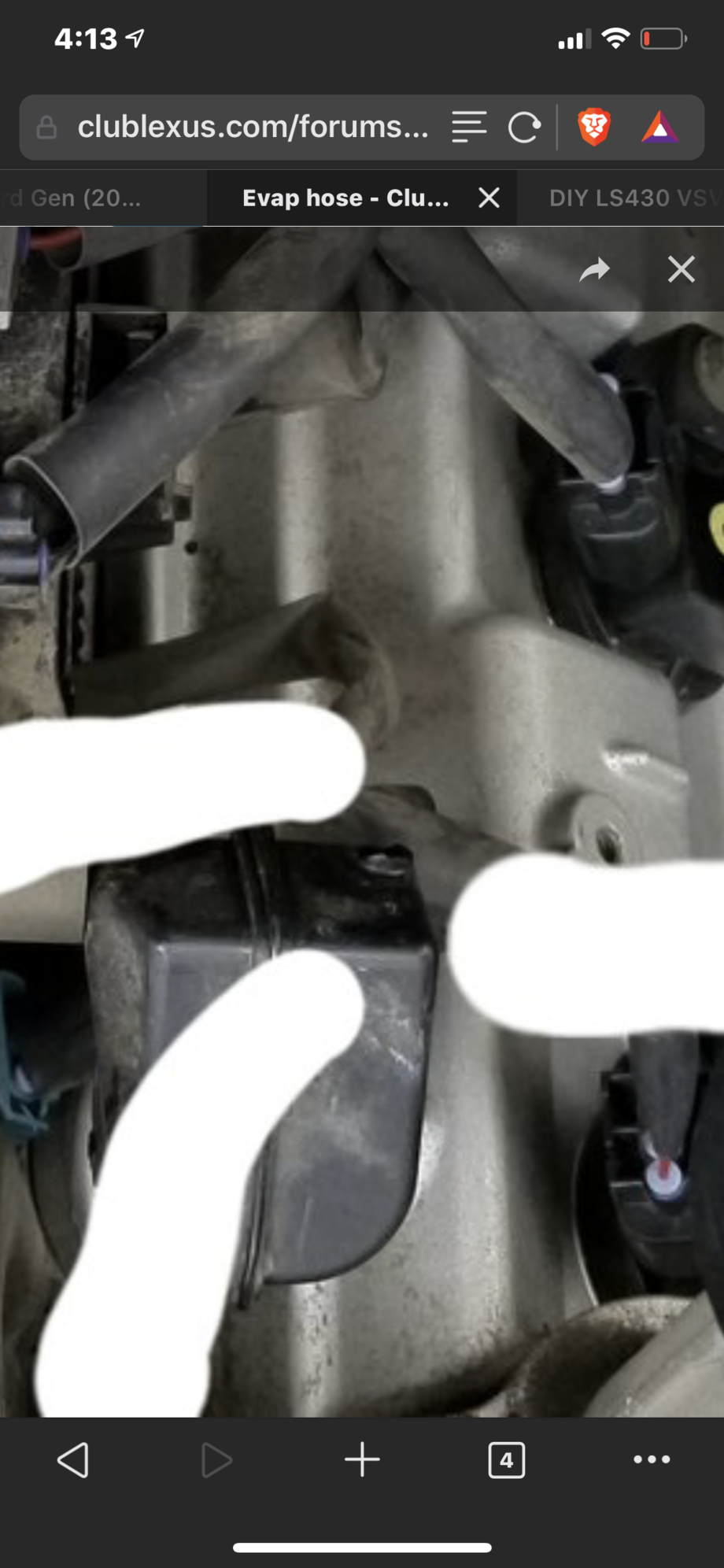

I'm not to sure where this go into. Not sure if it even an evap please help.
I dont know where this would go into. Please help!

This is a very informative thread on the EVAP system but it's mostly diagrams. There is a pic at post #79 that might help you...
Type "LS430 EVAP hose" into Google and look at the pics

Looks like the nipple on the black box is broken

The same thing happened to my car. The box is listed as a hose in the parts catalog. It is completely hollow inside. I eliminated mine years ago with a piece of bulk emissions hose from the auto parts store. No issues in 30k miles.

I replaced that small black box on my car along with every one of those small vacuum hoses (from Lexus) in the engine compartment. It was approximately $30+ for all the hoses and the box. Unfortunately it did nothing to fix my DTC code (PO440) and I have learned to live with it as the car runs and drives like a top otherwise. Gas mileage etc are all good.

Here is the part you will need. There are several listed on eBay for around $15.
