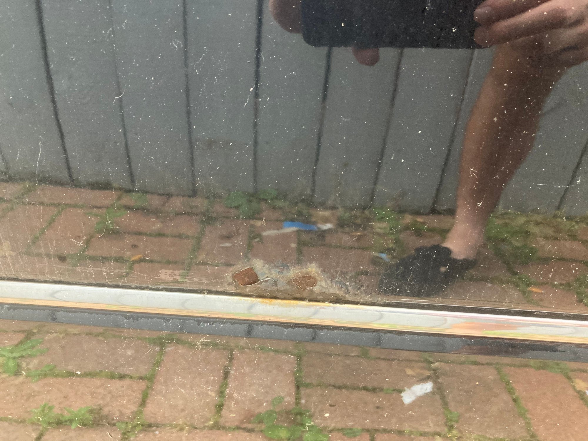

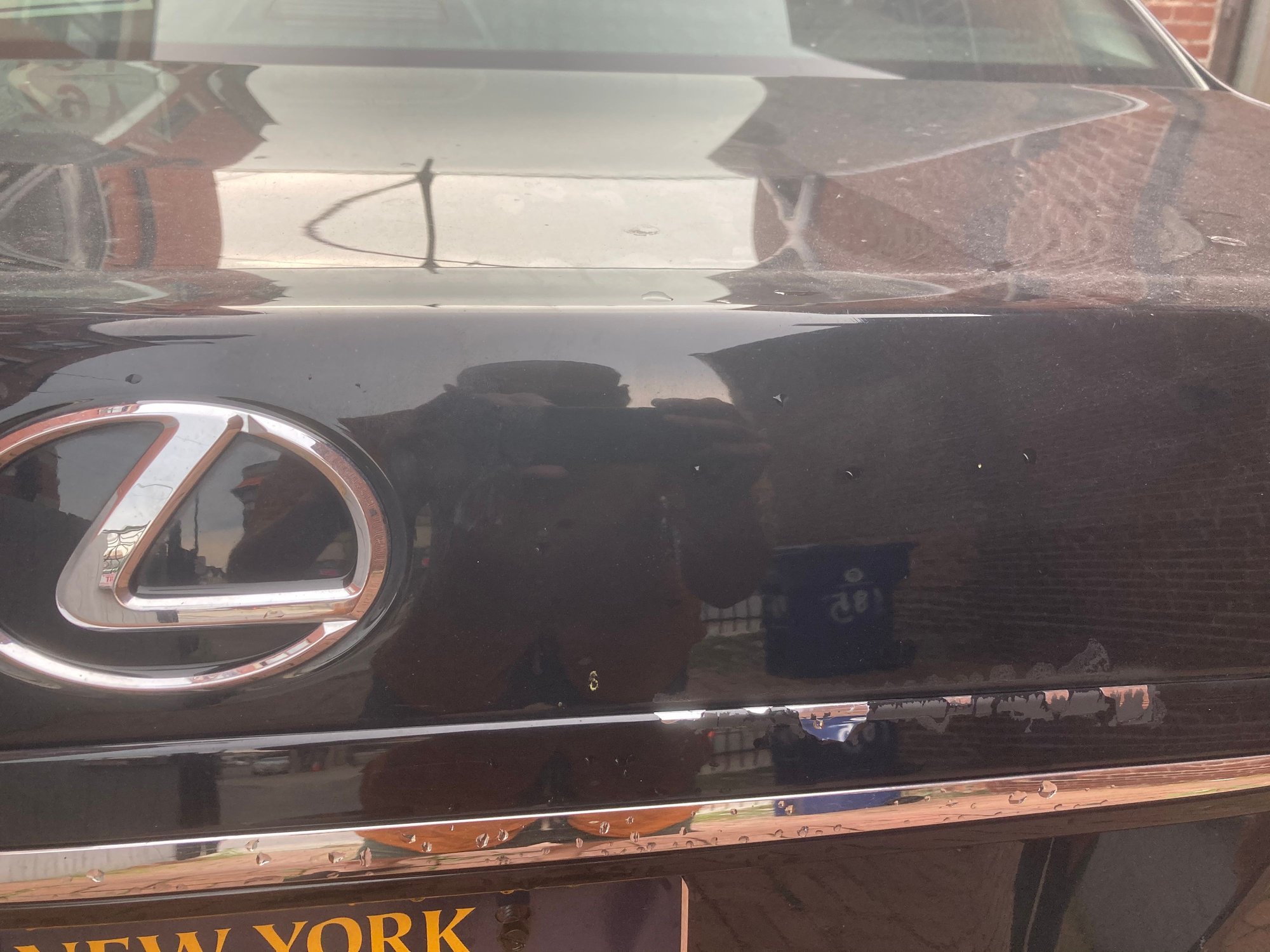

I bought this last year and would like to actually put some life back into it rather than driving it in beater condition. The out of state dealership neglected to show me this specific damage and I made the mistake of not asking specifically because I couldn't see it from the full car shots. Trying to get an idea of what fair pricing looks like on these.

I think that the photos are insufficient to give an accurate dollar figure for repair. I do think the OP meant dollar figure. But, going to a body shop that you're likely to actually use is best in any case as there may be damage not shown in the photos. The "door sills" and underside of door as well as the sheet metal behind the trim strip on the trunk. Getting paint to match and blend in can sometimes require large areas to be refinished as well as the possibility of hidden damage. Sorry to hear that there was some undisclosed damage from the seller. Hard to tell from photos but either a clay bar will brighten up the finish in the undamaged areas or a good polish/buffing by machine may be needed. A good car detailing service can do this for you.

I've not had good experience with rust. It's a cancer, it keeps coming back until the metal is cut out and replaced imho. Is that the dreaded rust on the door, can't really tell. I remember a ton of UK threads discussing it.
Looks like the trunk has been touched up before, if it were me, I'd just touch it up. My uncle ran a shop and I used to ask him how come I see beautiful brand new S classes and 7 series and their paint looks funny when clean on a sunny day? Meaning I know it's body work, but why would someone with a car like that accept work that can be seen with the human eye?
Why wouldn't shops do a better job than that? My uncle said because in a shop time is money, and we're not doing the 200k restorations that you're watching on TV. Most people, don't even notice. I dont know if I'm using the right words but the orange peel is almost never correct once a body shop touches the car. The color is perfectly matched, the texture isn't. In an accident, what can one do? But if cosmetic, I'd leave it alone....my .02

Doors are dead, that's rust in the panel. Price out new doors unless you want to chase the issue endlessly

As others have mentioned, you're better off buying donor black doors than getting that rust repaired.
The trunk trim piece is removable, so you should be able to paint it separately for a very fair price.
