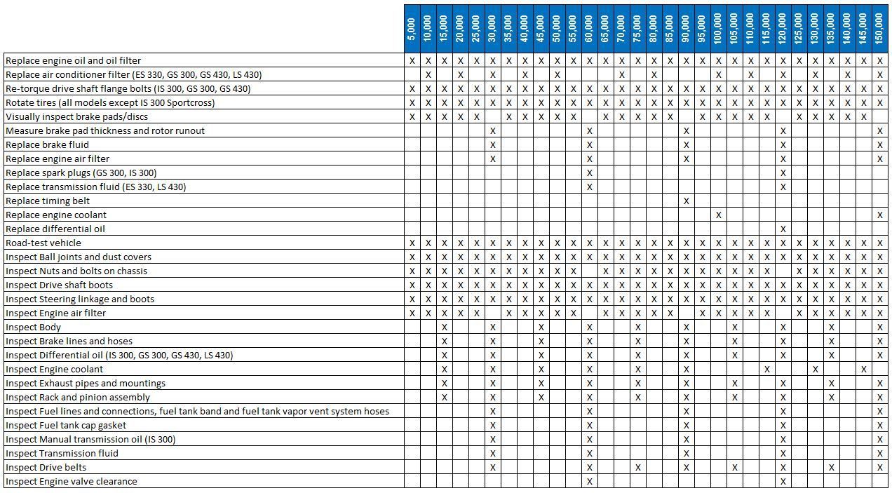

Hi All,
Can you please tell me what the following services entail?
1. 160,000 miles.
2. 165,000 miles.
3. 170,000 miles.
4. 175,000 miles.
Thanks,

Attached is the 2004 LS430 Warranty and Maintenance booklet (the scheduled maintenance section starts on page 97). Please note that maintenance schedule is by Age and Mileage, whichever comes first.

I rearrange the maintenance schedule on the spreadsheet below. You may use your own judgement to determine what the pattern is telling you.
