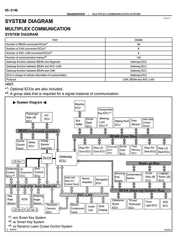

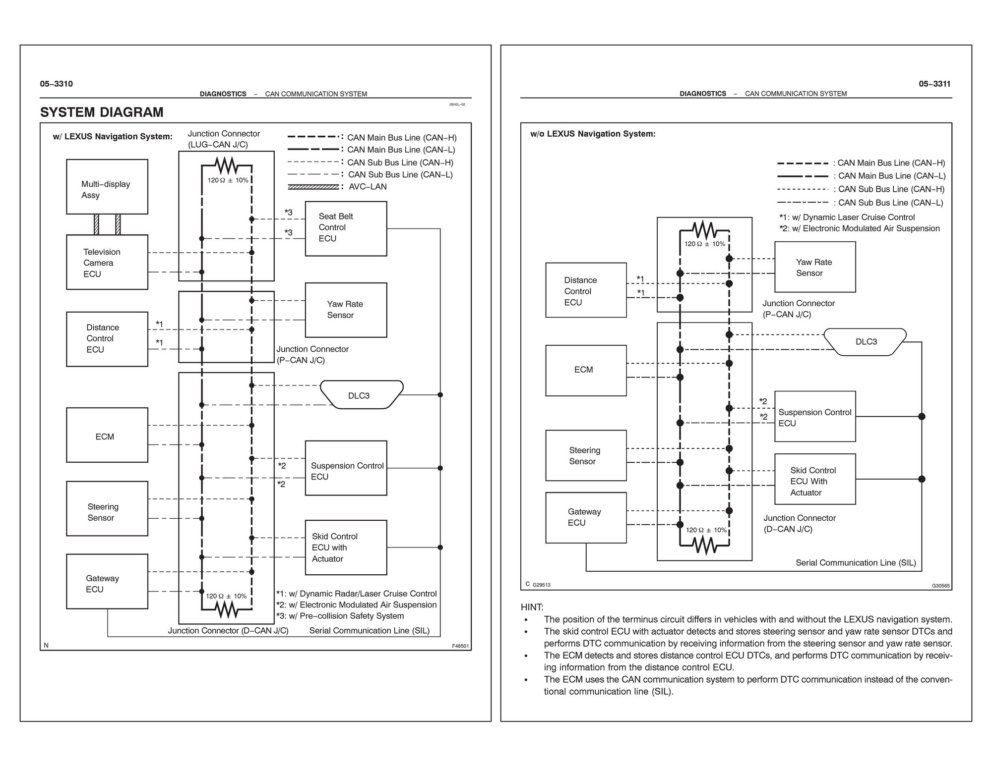

I recall seeing someone post a chart for diagnosing that showed what components were controlled by which computers/modules...I can't find it...anyone recall?

Awe maaaaan… no bites, I'll try searching some more...can't believe I can't find it because it was posted a few times, wish it was in the sticky

thanks!!!!
