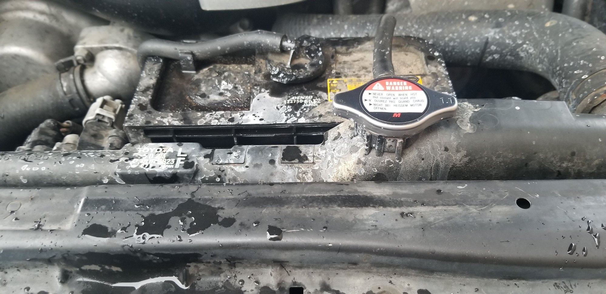

04 LS, 216k miles, original radiator and tank.
Two weeks ago, I had Lexus dealership install a new starter. I'm not linking this repair to the current issue, but wanted to mention it since a couple of the coolant hoses are detached and radiator bled to perform this service (according to Lexus).
Below are pics I took of the spray I am getting. I replaced the radiator cap thinking the old cap is losing its seal and allowing the coolant to escape. However, the radiator itself is not losing coolant, but the reserve tank is. I have filled the tank to the full line, driven the car, and the level has remained the same. After 8 hours of sitting, the tank is empty. ALso, sometimes the tank empties when driving. I plan to get into it today and see where a leak may be coming from, but wanted to check here and see if anyone has experienced similar issues, and what the fix was.
The underside of the air intake cover show the spray. The liquid you see in front of the radiator is water dripping from the hood after a rain.

You need to clean the entire area, pressurize the system, and go from there. Not many radiators last that long, so it might be an issue or soon to be one. Pressurize the system and let it sit for awhile or overnight. Good luck and let us know how you make out.

Didn't take long to find the leak. Pumped pressure to 14 psi and it started flowing. Looks like a new radiator is needed, unless there is someway to seal the area it is leaking.

Looks like there's a crack in the plastic rail, and this is the exact location of the leak.

There is no proper repair of your radiator. You are fortunate to have made it this long. You can pick up an aftermarket Denso for a fair price. Installation is reasonable. If you go for an OEM from Lexus, of course you'll pay that much more.
