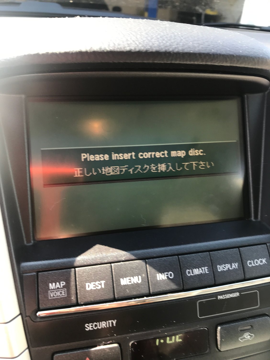

Hey Steve quad did you ever figure out the problem. I have the EXACT same issue with my 06 rx330.
I changed the battery and now have the Japanese screen of death. I tried tying the battery cables together. I even took out the dvd unit and disconnected the circuit board from the player. The disc is flawless with no scratches. I don’t know what the heck is going on.

oh wow, two separate problems?!
My truck worked flawlessly. I just changed the battery bc it was 3.5 years old and not holding a charge overnight. The battery was unplugged for 45 seconds while I swapped it out and now I have the Japanese screen of death and the phone buttons don’t work on the steering wheel. In my case, There’s no way that unplugging the battery caused the clock spring to break and the DVD player to fry.
