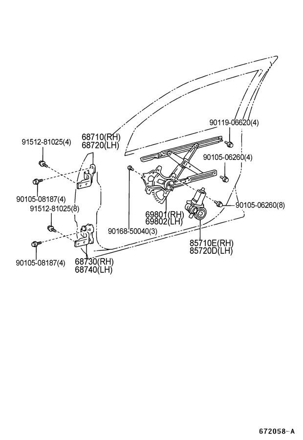

Some reference images to review in consideration of areas requiring lubrication.
Important to use the correct product.
