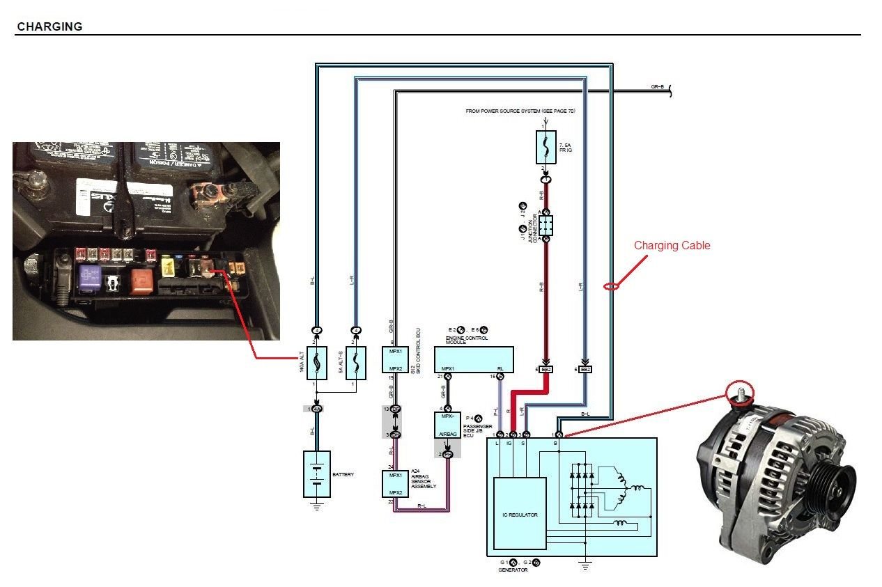

Originally Posted by Pvogel11
The car didn’t hesitate, mechanically wise, engine was running fine. My radio started stuttering, eventually my navigation turned off, then gauges started acting up & eventually shutting off. Then engine started to struggle a bit, (after electronics had already shut off) until the whole car turned off. I was unable to restart the car under it’s own power. I jumped it, but almost immediately died after removing the jumper cables. After changing the alternator, it drove fine, but died 30 minutes after. Then, I changed the battery. After doing so, it lasted for a good hour.
OK, let's see what conclusions we can draw from your descriptions...
1. Your car was running along fine, then the electronics began to shut down, and eventually the engine died.
[Possible explanation] Your alternator stopped working, or the cable going between the battery and the alternator (let's call it "charging cable") is disconnected. The engine and other accessories in your car began to draw their power from the battery and eventually draining it.
2. You were unable to restart the car under its own power.
[Possible explanation] The battery is completely drained when the engine died.
3. You jump started the car, but the engine died soon after the cable was removed.
[Possible explanation] With a bad alternator, or a bad "charging cable", the completely drained battery did not have enough power to keep the engine running upon removal of the external power.
4. You replaced the alternator but the car ran only about 30 minutes.
[Possible explanation] You must have recharged your battery (which was completely drained before) so you can start your car with the new replacement alternator. It lasted 30 minutes without getting recharged due to a bad alternator or a bad "charging cable".
5. You replace the battery but the car ran only about 1 hour.
[Possible explanation] Again, bad alternator or bad "charging cable". New battery lasted a bit longer, but was drained after an hour.
It's not likely that you replaced a bad alternator with another bad one. So I would bet that the "charging cable" is either cut or disconnected somehow. Good luck!
Thank you very much!
How hard would it be to track down/replace the “charging” cable for the alternator?
Once again, I really appreciate your help.
I suspect the 140A fuse in the fusible link box (in the engine bay just in front of the battery) is blown, which essentially disconnected your alternator from the battery. If so, check out the link below for repair instructions...
https://www.clublexus.com/forums/ls-...ible-link.html
Otherwise if the 140A fuse is good, use a multimeter to check for continuity of the charging cable between the alternator and the positive battery cable connector.

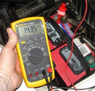

A quick check of your charging system at Advanced Auto will let you know if the charging system is bad. Or even better, grab a cheap multimeter. The voltage should be slightly over 14v (see photo) at the battery terminals with the car running. If not, you will have to trace it to a fuse or the cable from the alternator or battery. But let's make sure you're getting the proper voltage first and go from there.
