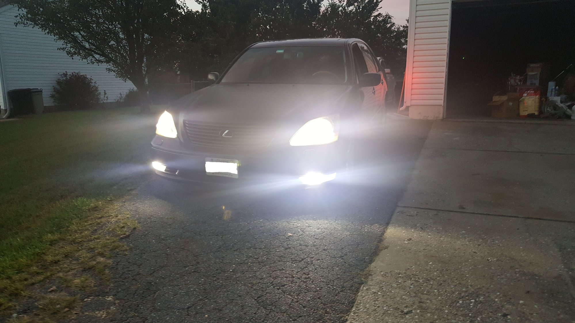

These are the bulbs I installed. I haven't had anyone flash me about the lights. And when driving, they are cut off below the headlight line. I'll get some pictures on my drive home from work.

As many other forum members have stated the 3rd gen LS uses the same 9005 bulbs for the high beams and daytime running lights. I would recommend getting the 9005 Xtreme Pro LED kit with the DRL LED Driver option which will allow the DRL to dim so that they aren't at full brightness as LED bulbs can't dim.
