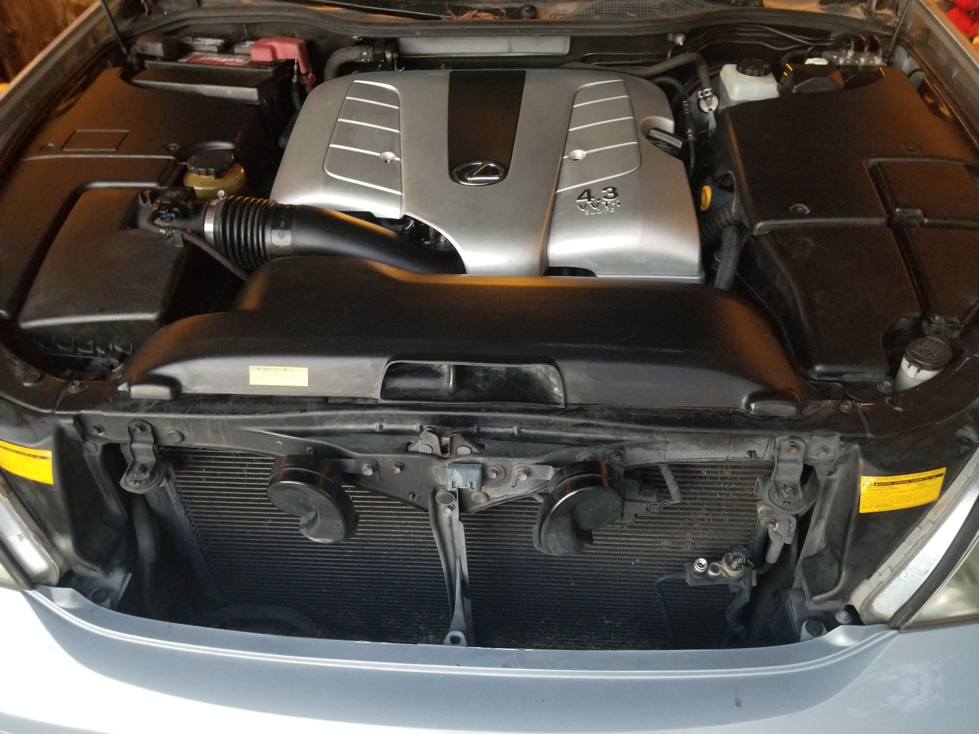

I was going to be needing another vehicle and my friend had this sitting.
While I knew nothing of these cars I decided to purchase it from him for $500. All I knew was that the motor was locked, interior was worn and that's it. I had it towed to work to see what I was working with...
Thank God everything removed was in the trunk. I started searching for and best deal I could find was one out of an sc430 with 78k miles.
Had to swap the lower oil pans, engine mounts and wire harness. Went ahead and replaced timing belt, waterpump, rear main seal and front seals while it was out. Here it is ready to go in.
Only small problem was a/c fan motor is bad kicks on only when it wants to. Decided to give it a quick bath to clean off all the dirt from it sitting.
Took it home to finish everything else at home, I was really surprised at how well it drove even with a bad left front strut.
Decided to clean up the engine bay a bit and the wheels. Really have t had too much time to do anything else.

Not at all the motor was $1400, labor was $800 and misc parts $200 so right about $3K. Only thing I really need to replace is the a/c fan motor, doesn't overheat but a/c gets hot when not moving. Also want to replace wheels and tires before I start to drive it daily.
Doesn't have air suspension so I'm good there, was able to find a set of used struts for now until I decide which way I want to go(coils or springs).

Car has 176k miles, I was actually a little surprised at how good the exterior was for that mileage. It seemed like the previous owner wasn't keen on doing oil changes, had minor sludge but the last two rods in the back of the motor were dry and bearings seized. I will eventually tear the motor apart rebuild with 1uz rods if the block is good.

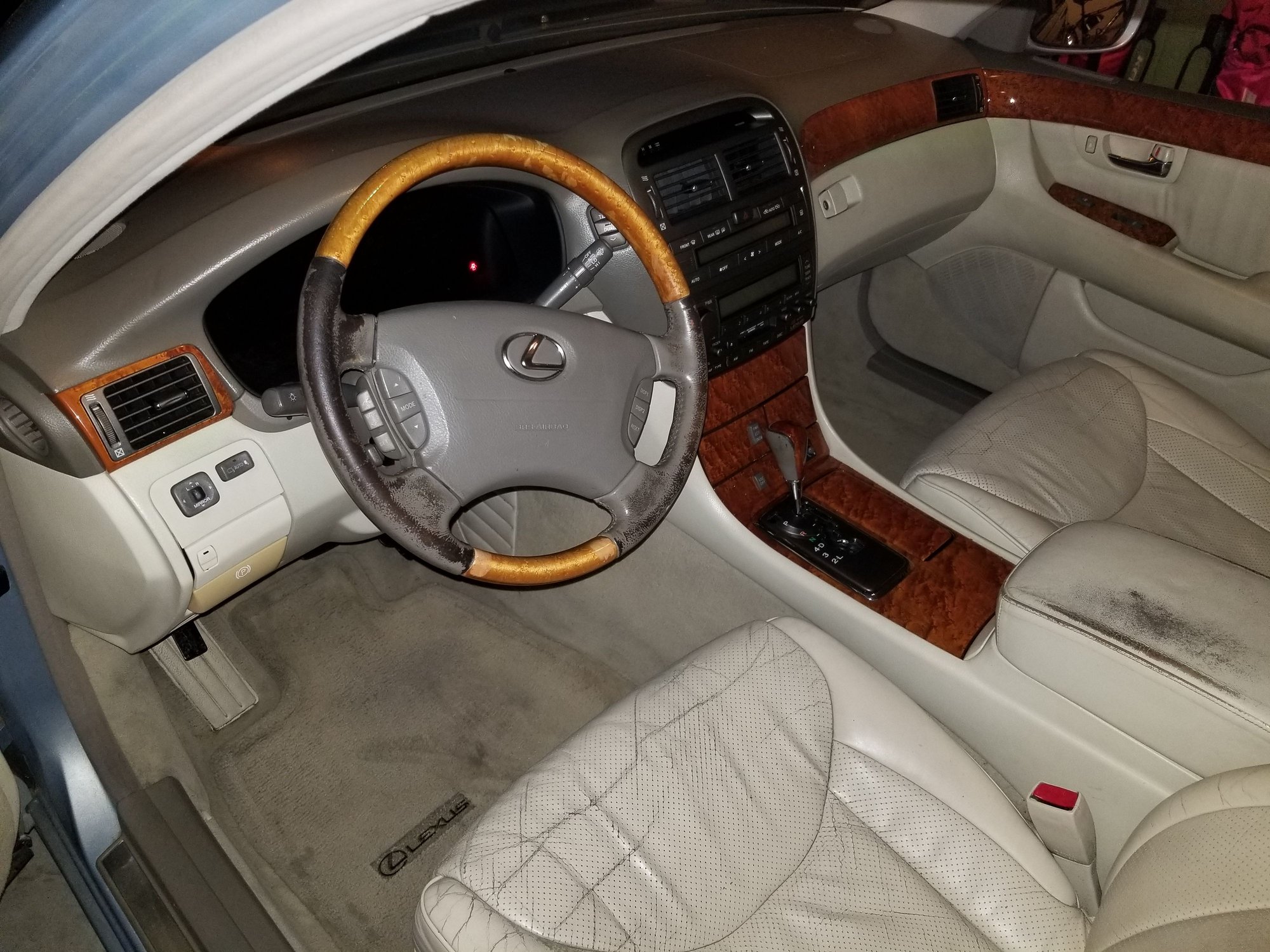

Only have a couple really haven't finished cleaning up the interior.
I did get bored the other day and decided to upgrade the center console power port to a dual fast charging USB.

Shesh, that interior has definitely seen better days
It looks like the door panels might clean up pretty well with some leather cleaner, but the seats, center armrest, and steering wheel look pretty whooped. I'm so thankful that my car has decently dark tinted windows to keep the sun from killing my leather quickly, plus living in the PNW, we don't have anywhere near the amount of sunny days as TX. I'd definitely want to get some tint on those windows soon to slow down the damage, as well as for preventing a quick death to the new leather when it goes in.
At least your carpets all look pretty clean, as well as the wood on the dash, doors, and console!

Yeah the leather isn't the best but I wasn't to concerned since the car was cheap. Eventually I'll have new leather installed along with the center console, everything else seems pretty good. Tint will be going in soon also, I don't think I've owned a car without tint before.
