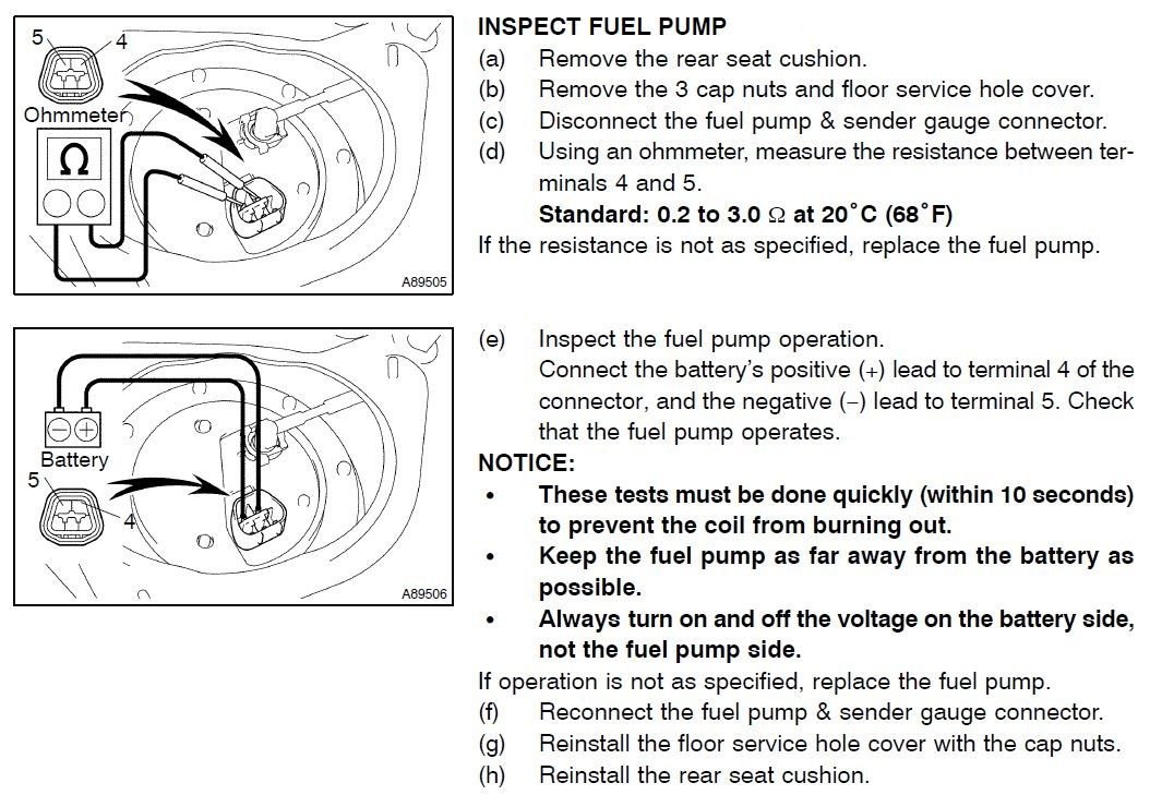

You have a good point about checking the fuel pump. If you suspect the fuel pump is the culprit, here is the inspection procedure...
gonna go pick up a dmm and check the resistance and check for power also.

i jumped the fuel pump relay thinking maybe i had a crappy relay. still does not turn over. so my relay could still be good. i followed that diag chart up above for the fuel pump. so i measured resistance terminals 4 and 5 of fuel pump i got 0.7 ohms. i think spec was 0.2-3.0 ohms. i checked for power at the connector 12v. so i can say my fuel pump is ok? but whats weird is i don't even hear it? like its super quiet? could a bad mad be my problem? i mean if it was a bad maf it should be able to start right but maybe bog before it shuts off?
