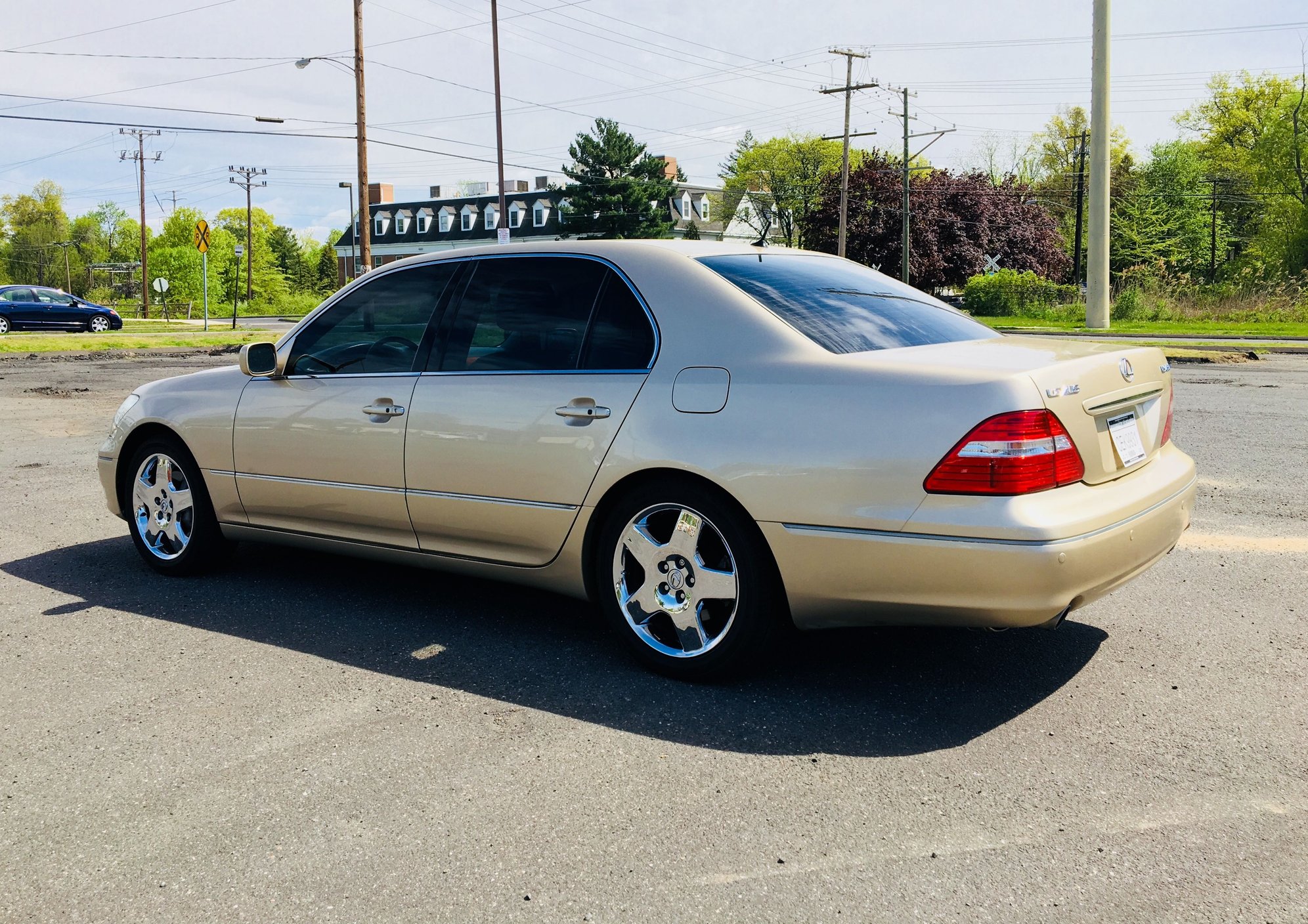

All I can do now is monitor the level and see if it drops again, but I just took the car out for about an hour and didn’t see a level change. I have been reading on the forums that this is somehow “normal”, since a lot of people have reported this but I don’t really buy it. Any insight? Pic after I finally put some tint on her:
