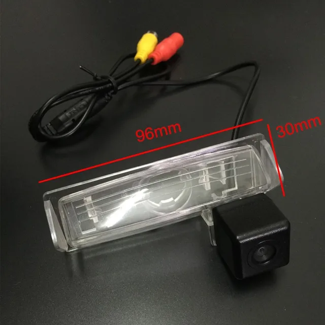

should look like this https://www.clublexus.com/forums/att...g-img_2504.jpg
the lexus camera should look very rounded and not cheap black plastic,
lexus camera here: https://www.ebay.ca/itm/04-05-06-LEXUS-LS430-REAR-TRUNK-LID-VIEW-PARKING-CAMERA-I/142667185555?hash=item2137a07d93:g:kQkAAOSwUH5aaMdM&vxp=mtr
ebay camera: https://ae01.alicdn.com/kf/HTB1uHvLL...pg_640x640.jpg
also there would be a part number on the camera if you do manage to get it out. i can also go out to my car and snap a pic of my backup camera if you'd like.
