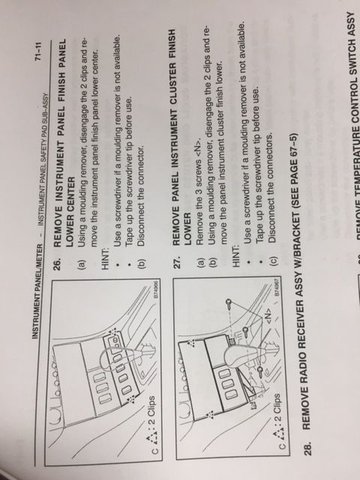

To update, mine was definitely broken. There are a couple of little tabs that hold the spring in place that were sheared off - pic of the old one below with the missing tabs. For folks looking at theirs in person, the spring isn't a wire; it's more of a chewing gum size piece of metal that's wound up but covered with a black insulator film.
I bought a used drawer from ebay for ~$25 and my wife (who is the mechanic in the house) was able to easily pop the front wood off my existing one easily using the tabs in the picture below then put it on the replacement box and re-install. Picture shows the ebay box wood installed on my broken drawer as an example.
I had saved off the instructions for this for when we put in the non-smokers box a few months ago, so took a picture of the specific instructions for how to remove and uploading here for future folks who encounter this as well.
