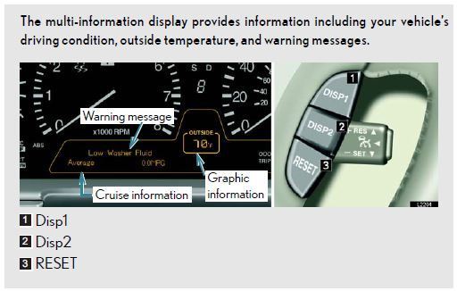

^since your radar shows up, your instrument cluster is fine.
R33, press the button that says DISP 1, and keep holding for a few seconds, you will see it bring up information, and you'd be able to cycle through different modes by pressing the DISP 1 button.
If you want to make the screen off again, just keep cycling through the options until it disappears(which is at the very last of all reading modes.)
If you were referring to the small box in the middle, where it is labeled "graphic information". Then you will need to press and hold on button DISP 2 for a a few seconds.
If your car has OEM NAVIGATION, then that small box will only read the outside temperature and display it for you.
If your car did not come with factory NAV, that small box will display the direction of which you're headed.(N, S, E, W, NE, NW, S, SW etc.)
AND the outside temperature. Separately.

I tried holding the DSP1 in for a couple seconds all the way up to a minute and still nothing. But if I hold the DSP2 button in the climate does go out. The button on the steering wheel (DSP1) feels a little different (not as stiff as DSP2.) I have yet to try the other method but will when I get the time (rain is a pita)
