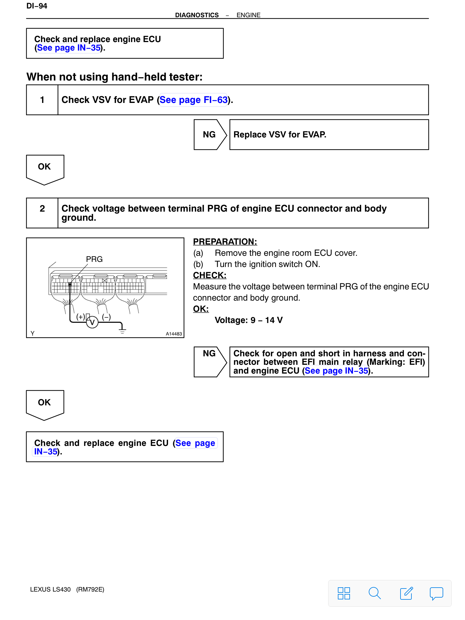

For some reason I can't upload more than one picture. I'll upload then one at a time.

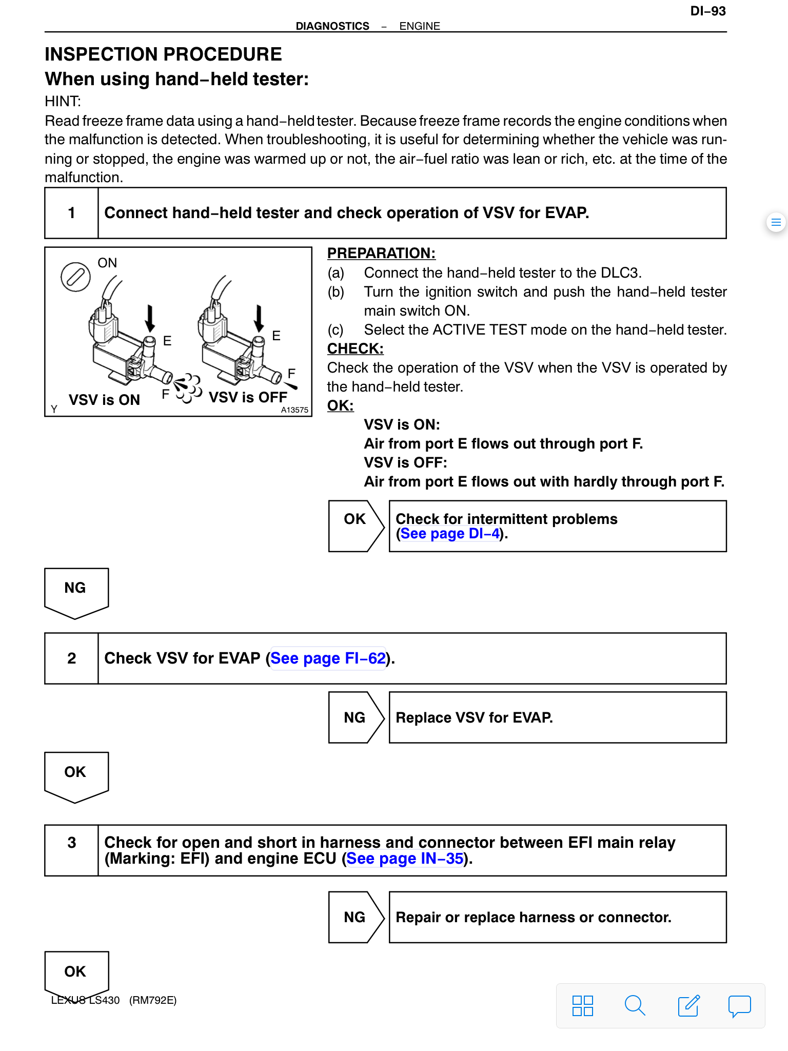

Here's another one

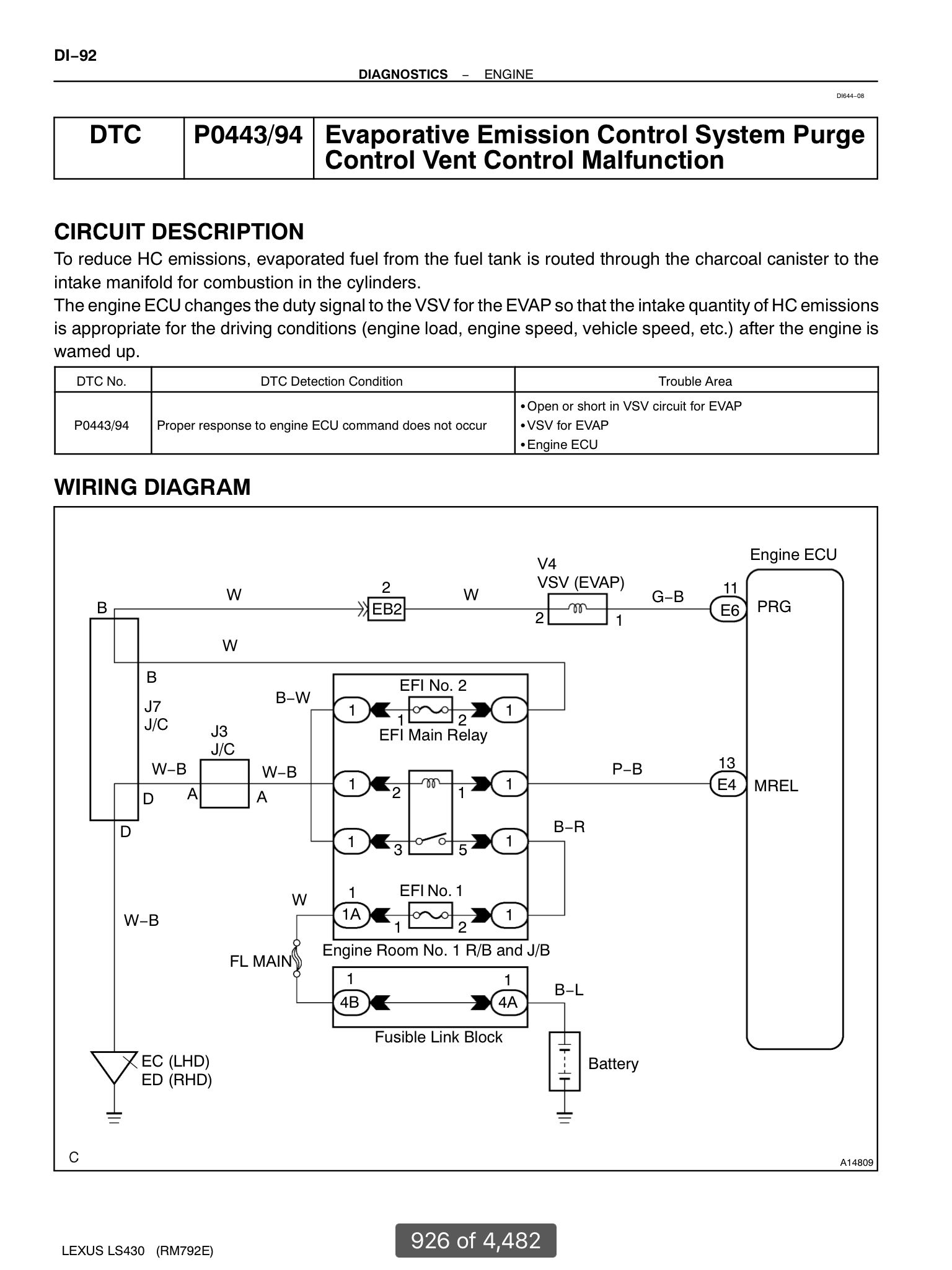

And another

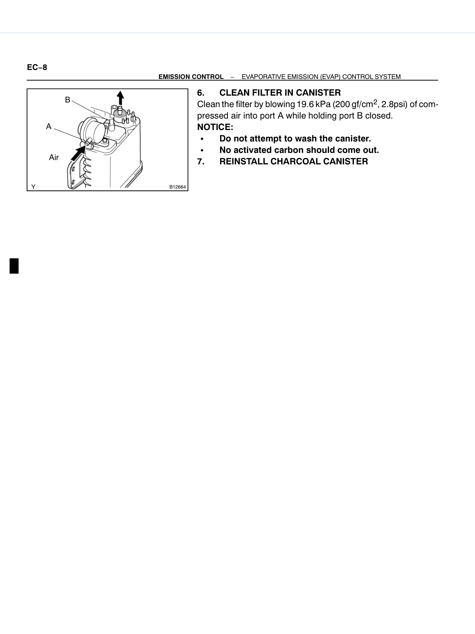

A few more to go

I'm showing codes P0440, P0441, P0446 all somewhat related to this thread but I'm having some trouble. A good friend of mine says my issue is a bad purge control solinoid valve... hsould I also check these vaccumm lines like the beginning of this post?
These codes together mean there is a massive leak somewhere in the Evap system. Usually this is due to a broken or disconnected hose. As a first step, I would carefully inspect all hoses in the Evap system to make sure they haven't fallen off their connector or have broken from age.

Yeah it was a broken hose I found it and posted in another thread. The evap test hasn't run yet since I found and fixed the issue. I found this test only runs with 1/4-3/4 of a tank of fuel wish I knew that before I filled up. Will have to wait until I get back home in the next few weeks....

Originally Posted by Brewmyown
It's either a leak in the Evap system or possibly the Evap canister. You already replaced one of the possible valves. Take a look at the Evap system component layout and check any of the lines or components.
Thank you for sharing this diagnostic documentation. Is it from EG001R-99?
