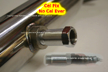

Not that I can think of, the exhaust will be louder and it will be a gasoline type smell (like an older car) while you're running. I wouldn't recommend it. And you'll get a "check engine light" on your dash.
The problem is, the cost to remove the cats and fabricate some sort of piping without them is probably going to be close to the same price as just buying an aftermarket cat that pops into place. I've seen them for around $150 a piece that are direct fit models. You're also not going to get any real performance increase
If you're getting a code that the cats need to be replaced and would rather not replace, you can buy an oxygen sensor plug "simulator" where it basically spaces the O2 sensor that's after the cat away from the exhaust flow so it ends the check engine light.
I should give all sorts of disclaimers about in being for "off-road use only" but people usually use them when they've done some performance modifications on the exhaust and don't want the check engine light to be on all the time. In places like California where they have over the top emissions inspections, they'd probably catch you. If I had a "beater" I'd probably do something like that as catalytic converters sometimes just get less efficient with age but still "work".

Wow BradTank,i havent seen anything about the spacing of the O2 sensors away from the exhaust anywhere and i must say its a great idea.
I got my CATS checked today and found out that i had a gasket which dint properly seal off the joint due to corrosion on the pipes,had it heated,cleaned and beaten to shape and after sum high temp resistant silicone the smell has vanished. As for the CATS,i think they will do for a while coz as u said even if they get old they work.
Where can i find the simulator plug btw?

You can find them all over the internet, including Ebay. They're usually around $10 to $15, it's just a plug with threads on it.
What that post-catalytic converter (downstream) sensor does is basically a "yes or no" answer if the catalytic converter is working efficiently. If there's as little as a 5% drop in efficiency, it can throw a code and say it needs replacement.
