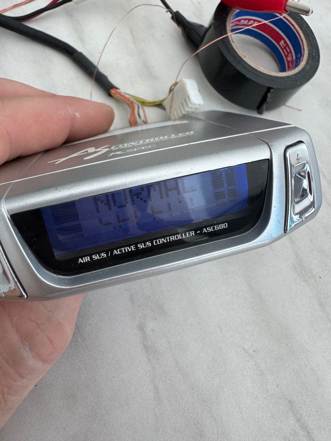

Default I am having the same issue, my rear wheels are sitting at quite different heights
Originally Posted by whiteSc3
Curious if you found a solution? Haven't had issues since I've had it installed(few weeks).
Then I was screwing around yesterday and put it in L. Since then the drivers side adjust but the passenger side is all the way down.
Controller is disconnected but both front and rear passenger are bottomed out and wont raise even with height hi switched on.
Disconnected the battery, jacked the front passenger up and down but no luck.
Any thoughts?
Thanks guys.
Brett
Did you find a solution to this Brettt
