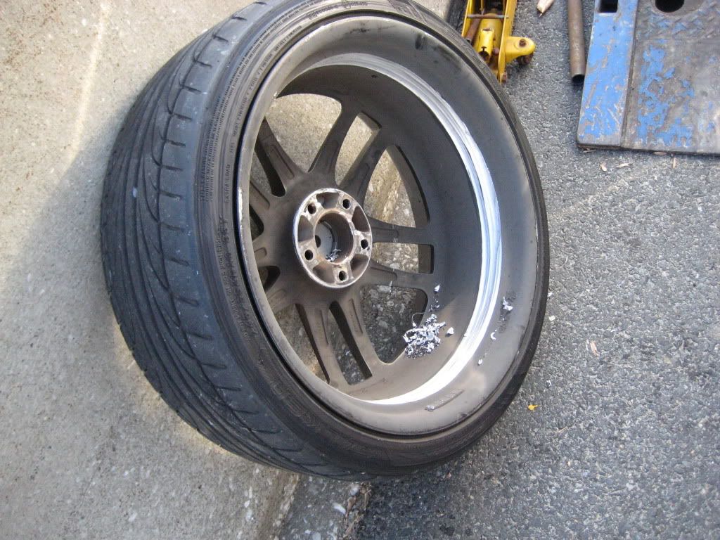

In order for you to use the VII, you have to make sure ur wheels have the sufficient slots for the nuts. It should look something like this, an not flat in which you can only use the VI.
http://i625.photobucket.com/albums/t...1/IMG_1185.jpg

Actually, as I believe Mr. Doback was referring to above, "Since it is 25mm's you wont have a problem fitting your wheels as well." The 25mm version would have sufficient depth to sink the mounting nuts so that they wouldn't protrude from the spacer. The 15mm spacer nuts would stick out.
