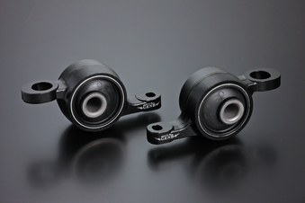

Maybe this would work
http://vip.genb.jp/item_detail/56/
Old Nov 12, 2010 | 07:30 AM
sojah's Avatar
sojah
Joined: Nov 2006
Posts: 4,918
From: JP (oki to be precise :D)
that looks like a winner ^ ^ ^
I had the same prob. but had to change frm 225/35 and ran a 225/30 on my 20x9 (+20) which fixed the rubbing, since i pretty much daily drive slammed w/ ss kit and datasystem controller, lmk if ur gona get these, look like they would def. work, ill pick-up a set too, thanx...
