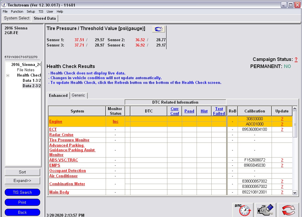

Sorry to bump such an old thread, but I've recently had the same problem
Not with a Lexus, but my 2016 Sienna minivan
A little history on this....
Picked it up last May and soon noticed that the PCS would kick in and slam on the brakes randomly while driving over Railroad tracks (sometimes coming to a screching halt)
Never had a Check Engine Light or warning (other than the instant PCS "BRAKE!!" flash on the dash as it took place)
Contacted Toyota, but they told me to go pound sand since it was way out of warranty
So I made a bunch of dash cam videos of it happening and sent them all to the NHTSA cause it was clearly a safety issue (see playlist)
https://www.youtube.com/playlist?lis...rHPzM1rfM2Y9Gq
The very next day, Toyota Corporate called me up and told me to take it to my nearest dealer to have it inspected and repaired at no expense to me and they would provide a loaner until it was complete
We scheduled a day that worked for me and they flew out an entire inspection team of field techs and production engineers to get to the bottom of it
I reproduced the issue and they saw it happen multiple times back to back
In the end, they said the millimeter wave sensor was out of range and they recalibrated it, but admitted that the problem was still there and that I should just monitor it, but they mapped out the location and launched an investigation as to why it was happening at this particular set of rails.
Since then, it still happened, just not nearly as often (like 2 out of 10 times instead of 8 out of 10 times prior to the "fix")
Anyways, a couple weeks ago I got a warning on the dash (Check PCS System)
Ran TechStream and came up with 3 DTC's (P1572, B2090 and C1A11)
Tried clearing them, but the B2090 and C1A11 codes would not clear no matter how many times I tried.
The P1572 cleared fine, but would come back after a drive.
Checked wiring to the millimeter wave sensor and all looked good.
Then I left it unplugged and it immediately threw a couple of lost communcation codes, so at least I know it's functioning.
At this point, I'm hoping it's just a simple calibration that's needed and not the sensor or ECU cause that $#!t ain't cheap
On a sidenote, would it be worth trying a zero point calibration?
I've done it before on older vehicles, but not on anything this new
Old Mar 19, 2020 | 10:27 PM
  #56
98SNAKETR's Avatar
98SNAKETR
Joined: Jul 2015
Posts: 67
OK, so after a month of mucking around with this thing, I actually stumbled upon a Russian repair manual for 2006 Lexus IS and GS models that stated how to adjust the radar axis beam
It was super simple, so I gave it a shot on my SIenna and IT WORKED!!
Here's a short video I made:
The warning is gone and everything seems to be working as normal
Old Mar 20, 2020 | 09:37 PM
  #57
98SNAKETR's Avatar
98SNAKETR
Joined: Jul 2015
Posts: 67
Confirmed all codes Cwere cleared earlier today, went through several drive cycles and all is good
ConfirmConeCC
onfirmed all codes were cleared earlier today, went through several drive cycles and all is goodonfirmed all codes were cleared earlier today, went through several drive cycles and all is goodd all codes were cleared earlier today, wentCon
Confirmed all codes were cleared earlier today.
Multiple drive cycles and all is good
