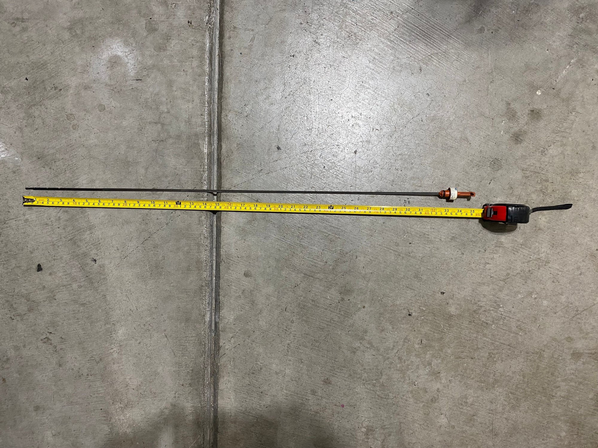

This has to be one of the poorest designs of a dipstick tube! Trying to put it back in takes several tries as it goes in about 3/4 of the way and won't go further.... remove/replace about 5 times then finally goes in. Anyhow, here is a photo showing the measurements.

Thanks I really appreciate it. I am guessing the first two marks or for cold and hot levels. The mark on the end one qt low?

No cold reading, fluid when hot (15 minute drive) should be between the two marks with the top mark being max level.
