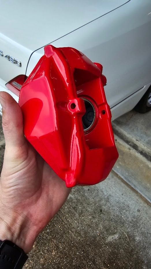

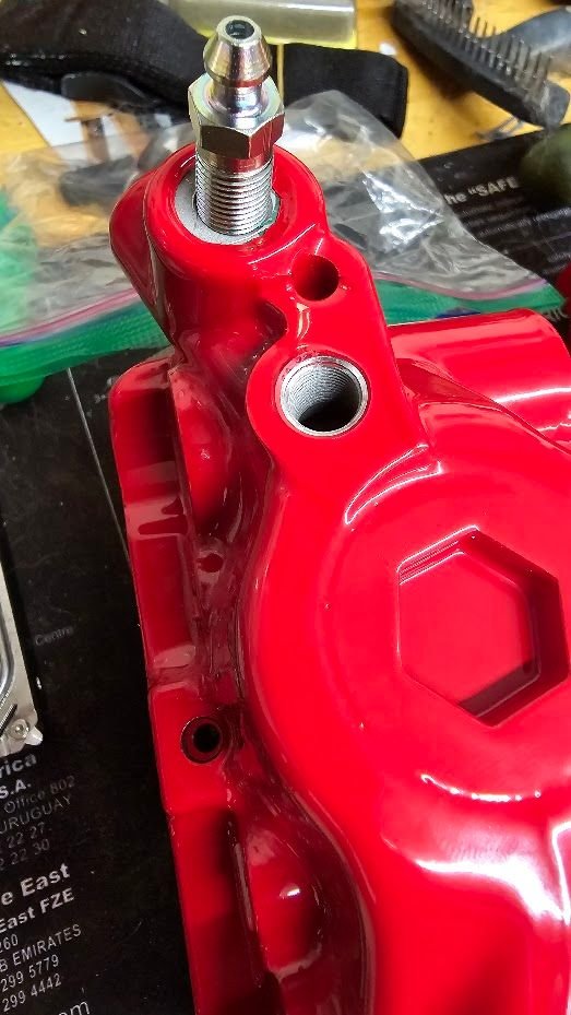

No issues. I did mine and was pleased with it. Biggest part is going to be picking who will do the work. Definitely use a second set to minimize your down time and only use an OEM seal kit. If you end up needing pistons, they are still available new.
I used R&P Motorsports and Coatings for mine and while the end result was great, the process was pretty miserable and I would NOT recommend them. My Google review for them explains in further detail...
You might try https://unitf14.com/
There are plenty of places in Houston but I didn't get a good feeling from any of them. Overall, it was an expensive project as I did rotors, pads, new caliper mounting bolts, the calipers themselves, rebuild kits, the cost of the service... I want to say like $1500 total all said and done. Also, Prismatic Powder will send you free swatches for any of their colors so you can get a better idea of what you want...
