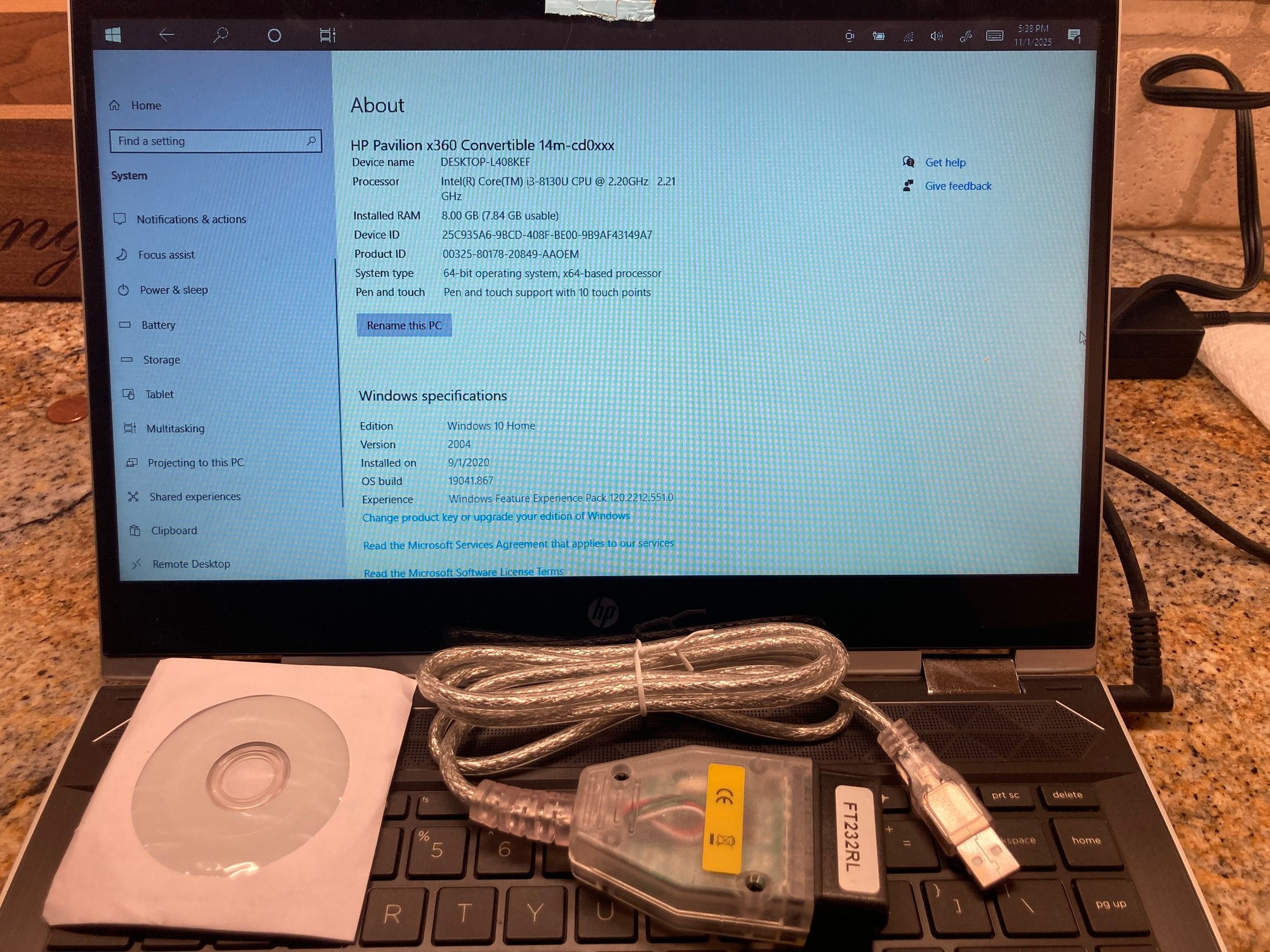

I recently set up tech stream. I tried it on a windows 11,10, and windows xp computer. I could only get it working on the windows xp laptop. the software doesn't seem to like newer operating systems.

Works fine on my win 11 just make sure you install the 64 bit driver for interface which is widely available.

Works fine on my Win10 laptop, but as Alex says ^^^ you need the 64 bit driver for the Mini-VCI.
I am running Techstream 12 so can't comment on later versions.

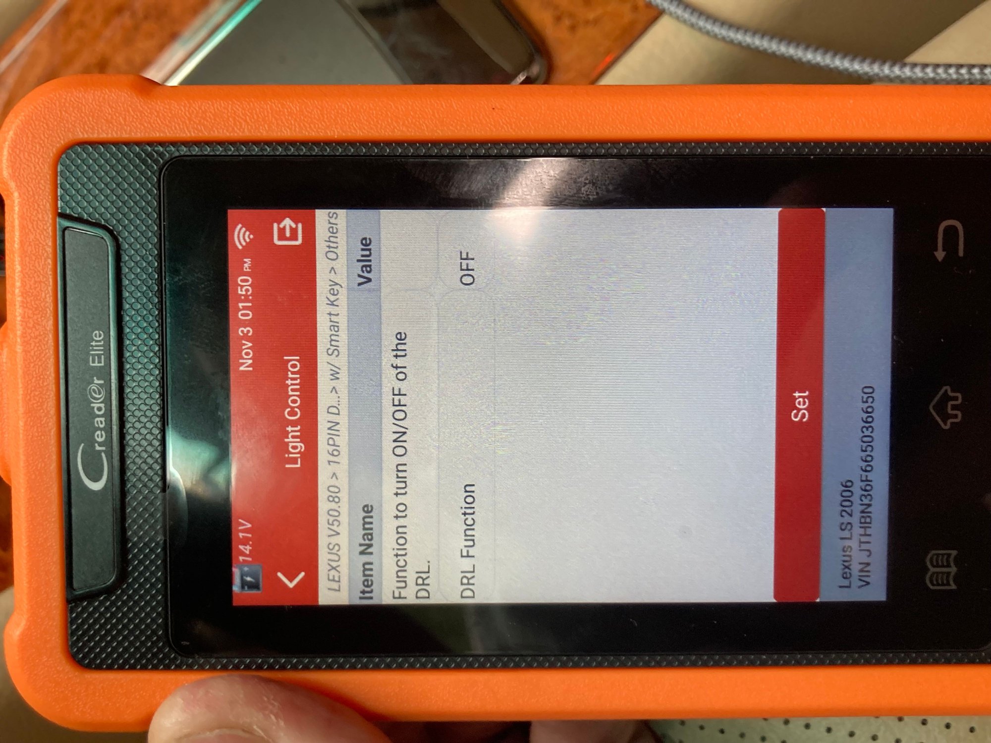

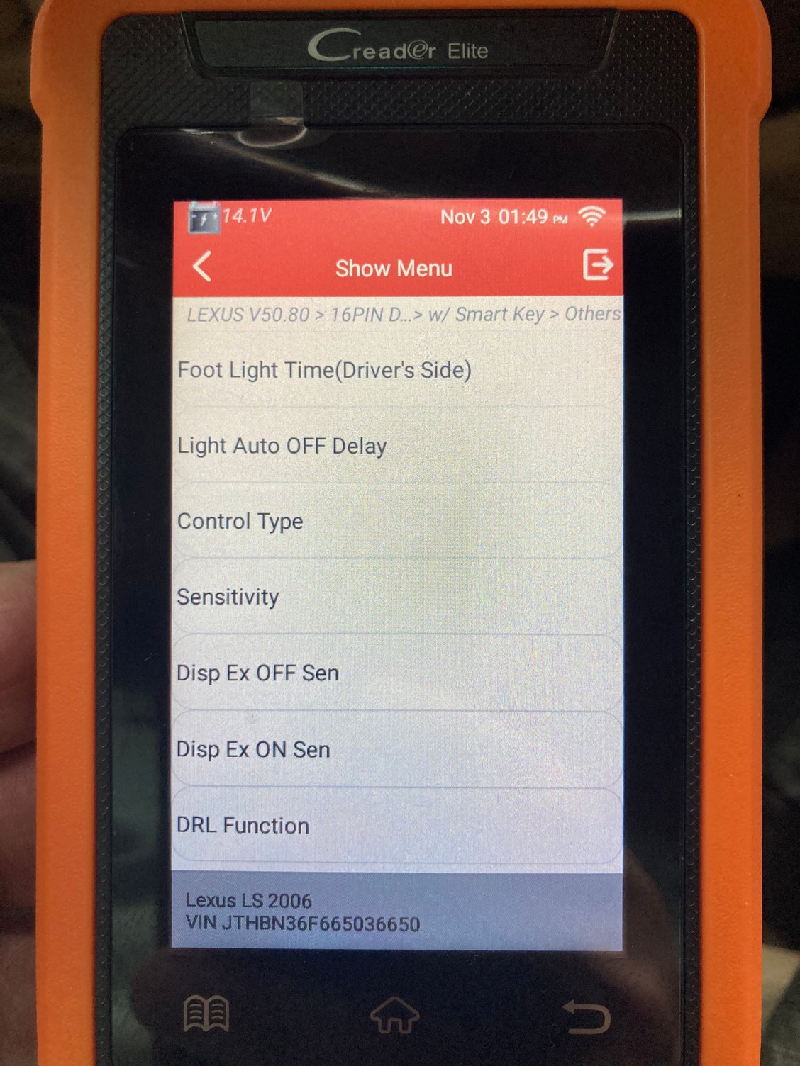

This is from Amazon, I was able to access what appears to be all of the Techstream controls. I’m going to try and program a key shortly.

Holden the 64 bit driver should come on disc with the cable if not google it and numerous places to download.
