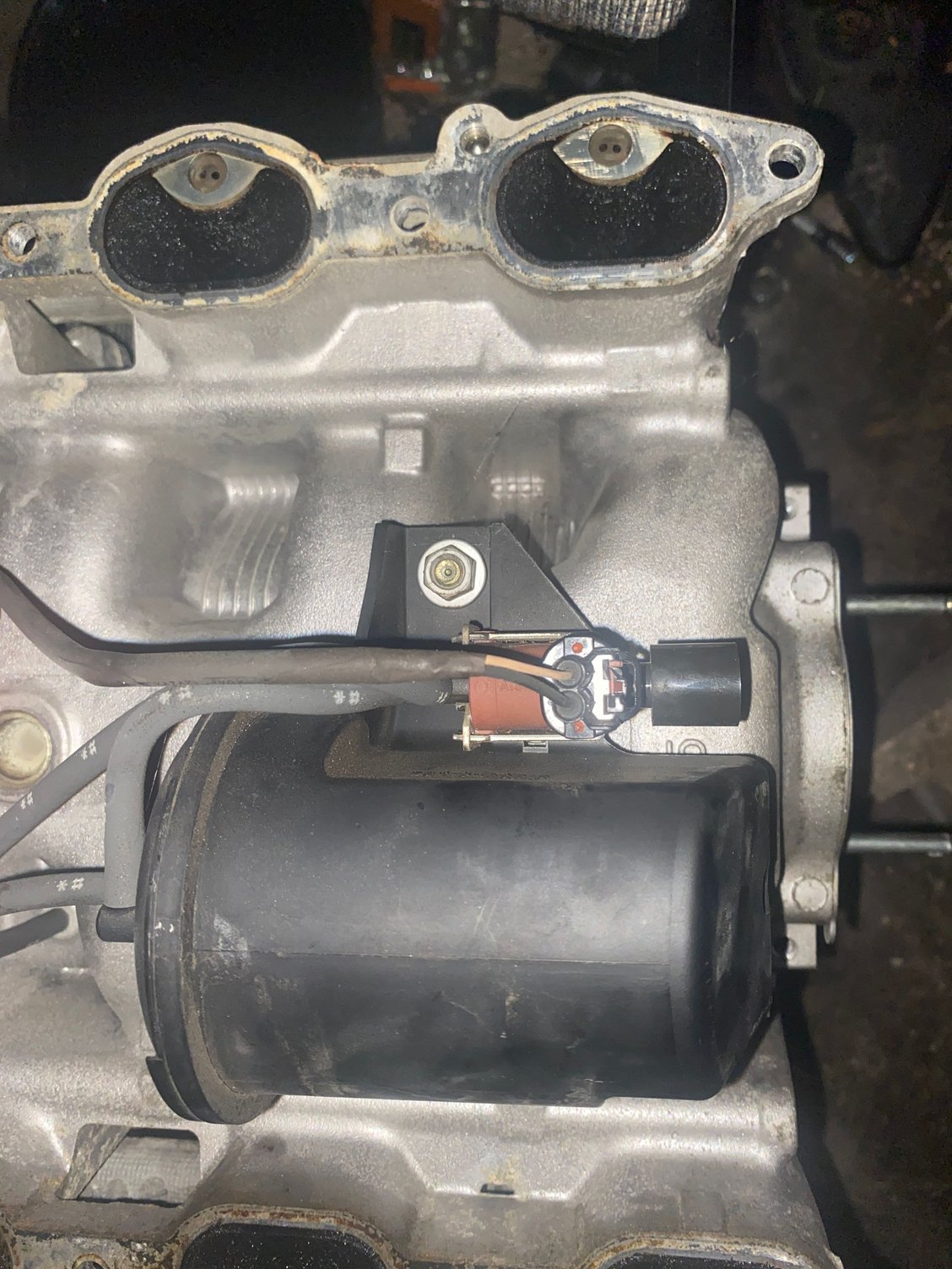

Can anybody help me find the plug for
25860-50121 not the whole vaccum switch doing knock sensors and the plug broke thanks

Every connector shell part number starts with 90980.
The last five digits can be found on the connector.
90980-XXXXX (XXXXX = what you find on the existing connector)
Also, a pic of the connector on your car might be more helpful than a stock photo of the part.
