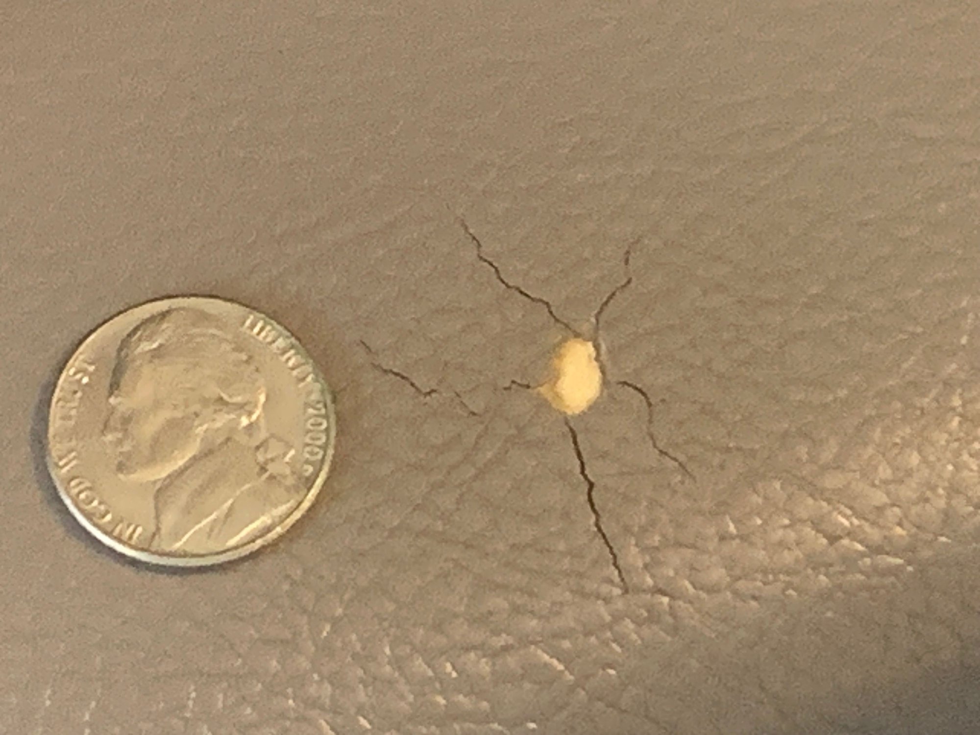

After 20+ years, my elbow has cracked the leather (?) of the driver's side door armrest. Can someone tell me the appropriate part number for the piece so I can price a replacement? Alternately, anyone have a recommendation of how to repair this without it looking horrible?

Long discontinued, when available door panel was about $2,700 from Lexus. There is no separate part number for the armrest portion see here

Is that the only spot that is cracked? Can be repaired. If possible get window tint it will cut down on UV exposure drastically.

Yes, that is the only spot and is right where my elbow rests.
The car lives in the garage at home and parks in an underground garage at work. Not a lot of exposure to the sun. (What sun in western Washington State?).
Any suggestions for DIY repair?

I've done this type of repair it requires:
SEM Soap (cannot skip this step)
Vinyl repair kit
SEM Classic Coat
Black hot glue sticks (for graining)
You can attempt to tint the vinyl repair paste to match but I'm not good enough to get it right. In my case SEM had the right colour of Classic Coat (Dark Ivory) so I did the repair then painted/featured in the repair area. Hot glue is to create a grain pattern glue blob, I got this from a spare piece of vinyl since I didn't want to risk damaging my door panel. You simply press in the graining blob into the partially dried repair paste.
If you can find an upholstery shop to do the repair.

The armrest is an integral part of the door card. It cannot be replaced independently.
Easiest solution might be grabbing a new door card from a junkyard.
The top dark-gray portion and the woodgrain strip are each independent parts. The window control woodgrain is also independent. Therefore, you could transfer those from your current door card to a junkyard one to maintain the wood match with the rest of your car.

The armrest can be replaced you need to drill out the plastic rivets on the back take out the piece put the new material on it and use plastic rivets to put it back on. You cannot use metal rivets it will destroy the door as its plastic.
