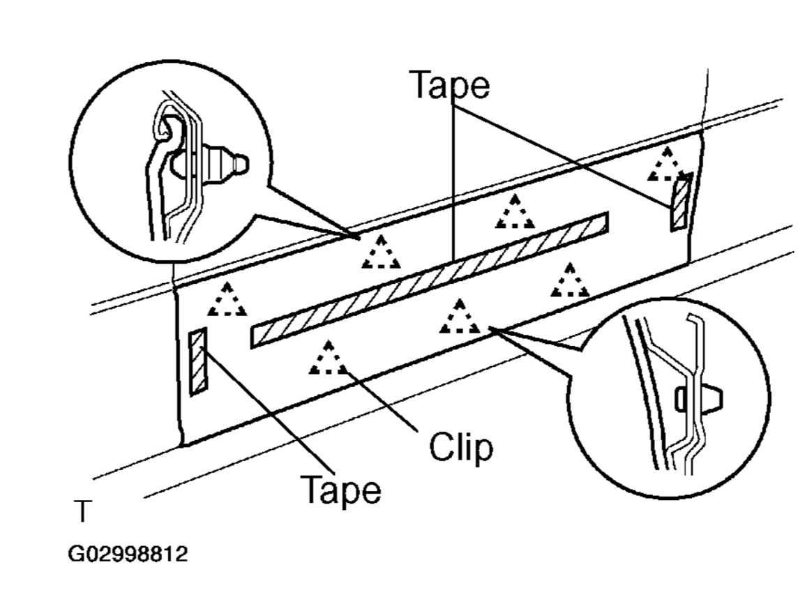

1. Remove the 4 nuts. All are 10mm. You will need a deep socket for the trailing-edge upper nut (upper-left nut in the pic).
2. The top row of clips appear to be locator pins. On my doors, they had no retaining force at all. The bottom clips detach on both sides fairly easily by pulling on the trim. Therefore, the main thing holding the door on at this point will be the adhesive.
3. Remove the tape with a long slender knife and a sawing motion. The big horizontal piece will be the main struggle. The diagram above is not quite accurate - the tape is more like 1/3 from the top instead of at the midpoint.

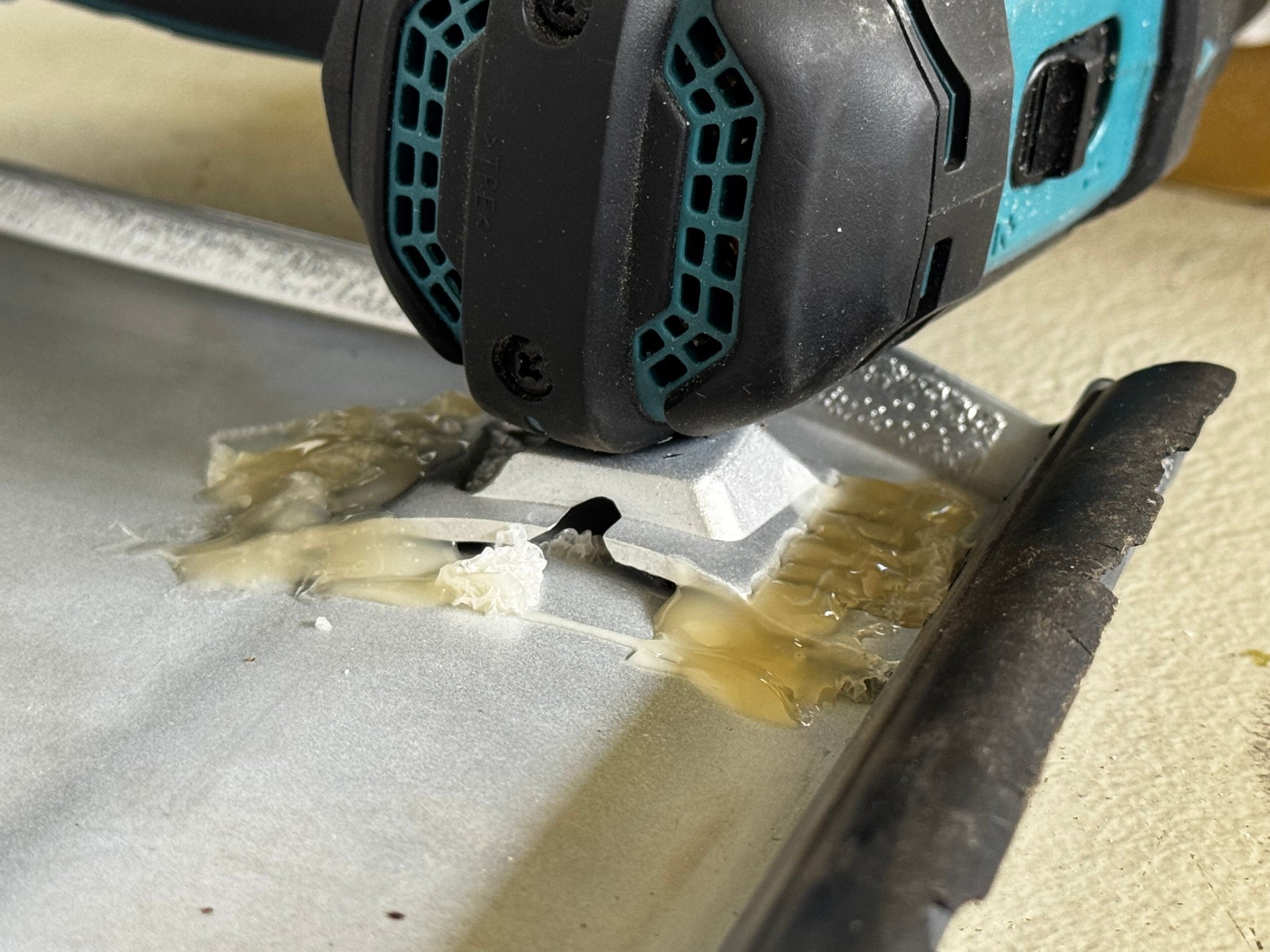

4. Use a 3M Stripe-Off Wheel to remove the tape from the door. It works very well.

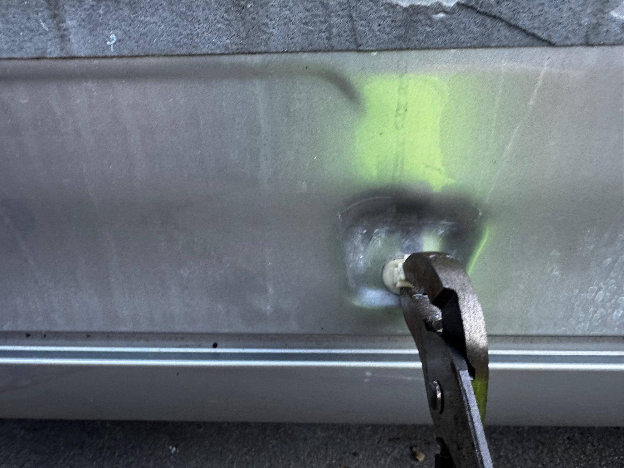

5. If the clips stay in the door, use pliers to pull them out. They will probably break. You could try to remove the door card and push them out from the inside, but the angle is very awkward and hard to get leverage. I did not bother and bought new clips instead.
