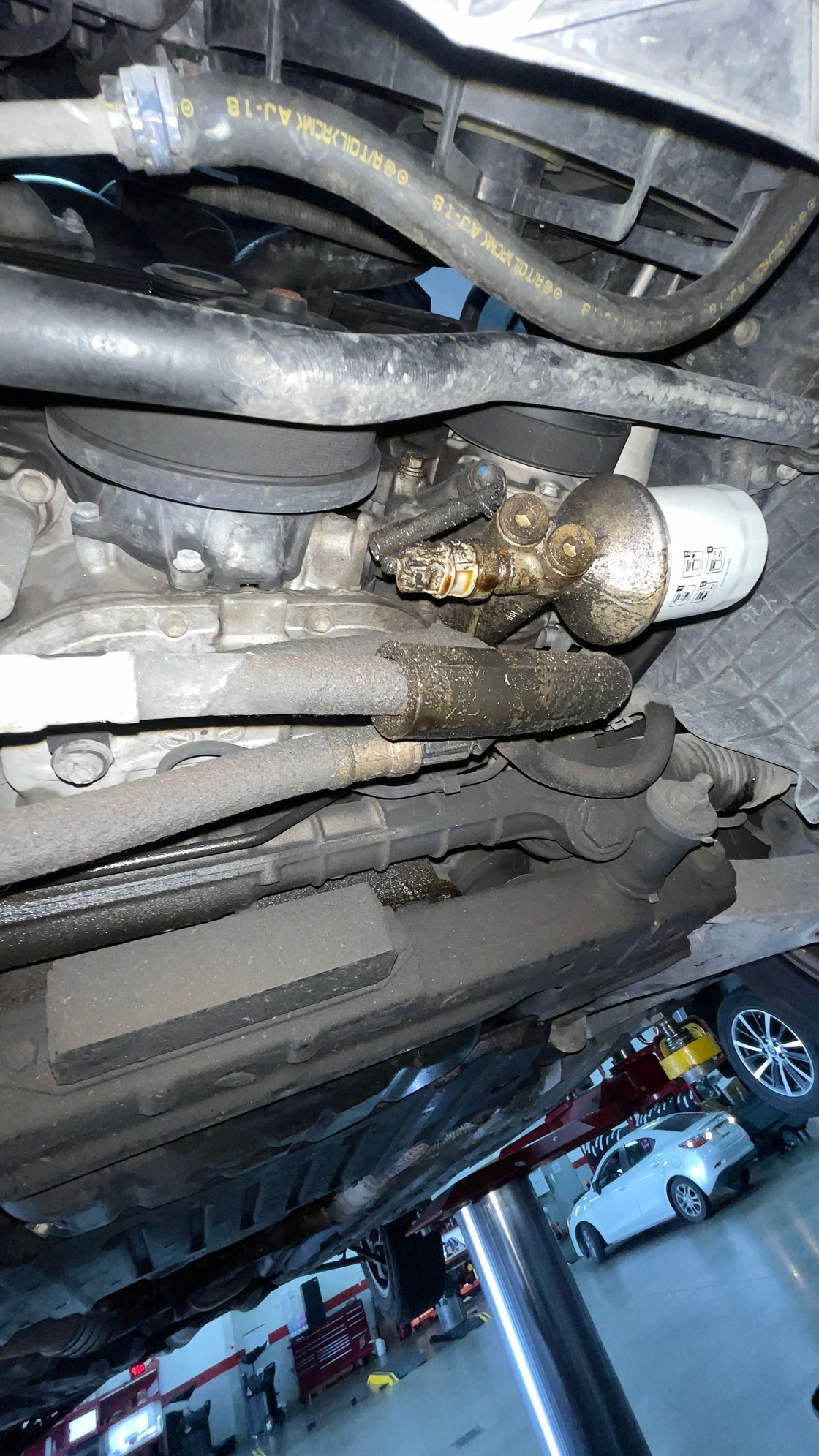

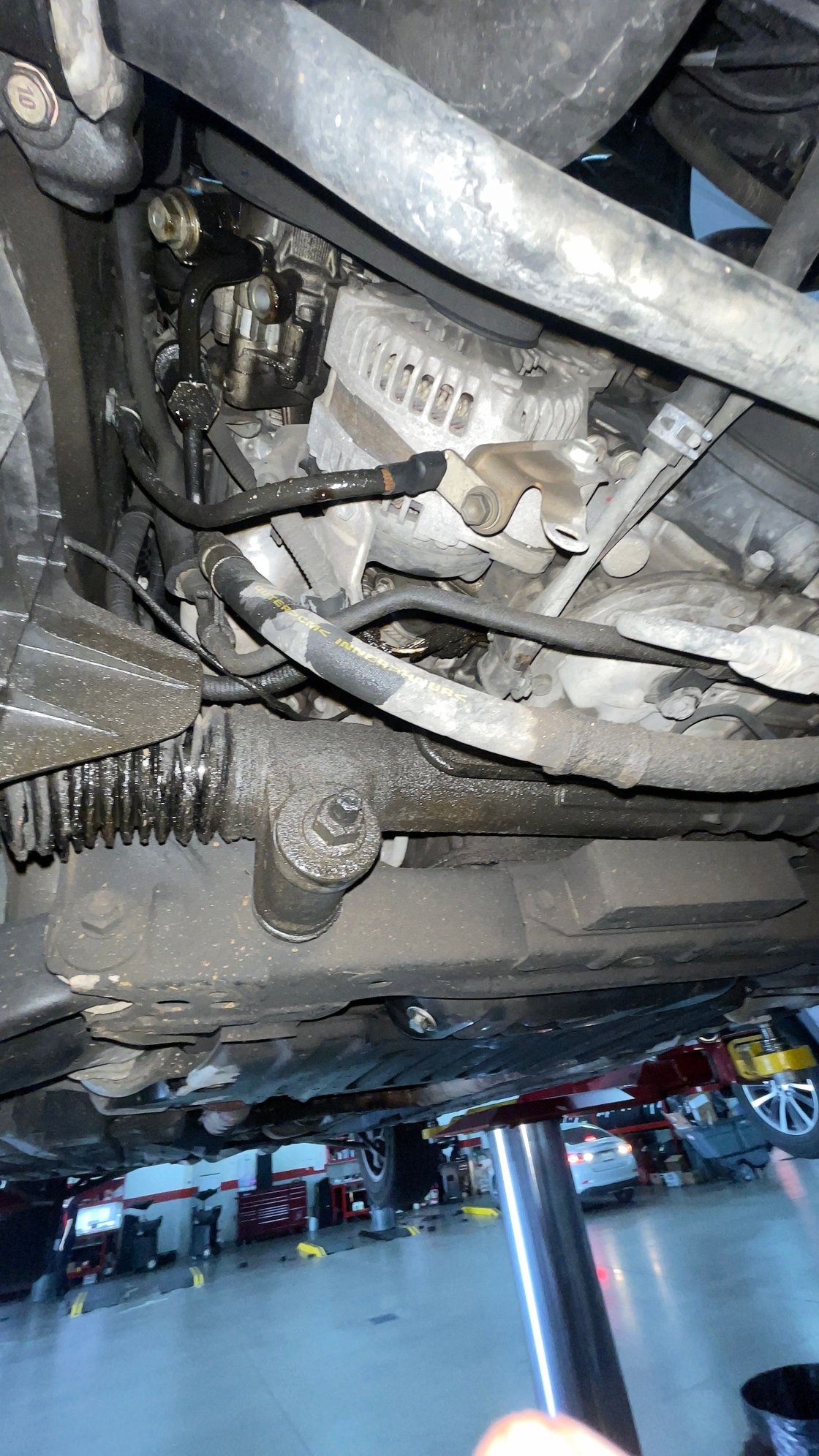

Hi just bought my LS430 a few weeks ago and it’s been having this mysterious oil leak. I looked online and on the forum couldn’t really find anything similar. Toyota dealer wasnt too helpful either. I would appreciate any help as to what’s leaking and the parts I would need.

The first pic is fairly vague; most of the wet areas could very well be power steering fluid.
The weak links in that area are the hose between the reservoir and pump, as well as the return hose from the hard line back to the reservoir.
The second pic shows a variety of potential issues.
The most obvious is the oil pressure sender/switch. The sensor itself typically doesn't fail, but the O ring inside does, allowing the leak.
This is an important sensor, buy the genuine Toyota part, not a cheap aftermarket band-aid.
The smaller (sub) oil pan is very wet.
Usually, gently snugging the pan bolts will stop most leaks. This also applies to valve cover gaskets. Emphasis on "gently" as over tightening will make matters worse.
This area could also be wet from a leak above it dripping down...
