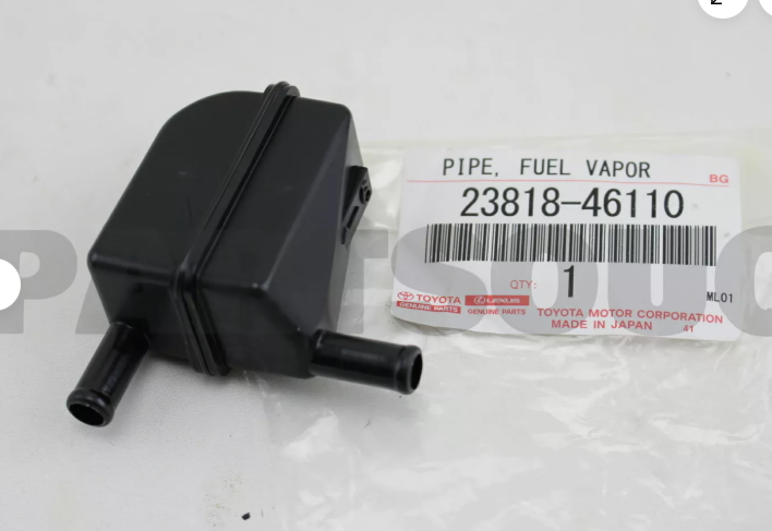

Got error codes PO440, 441, 446 and pulled the engine cover off and saw 2 hoses without anything between them. This was lying below them. What part is this?

Hello,
For the future reference, it is not a Valve, it's a Surge Tank for the EVAP System, here is a thread about it.
Hope this helps and best of luck!
