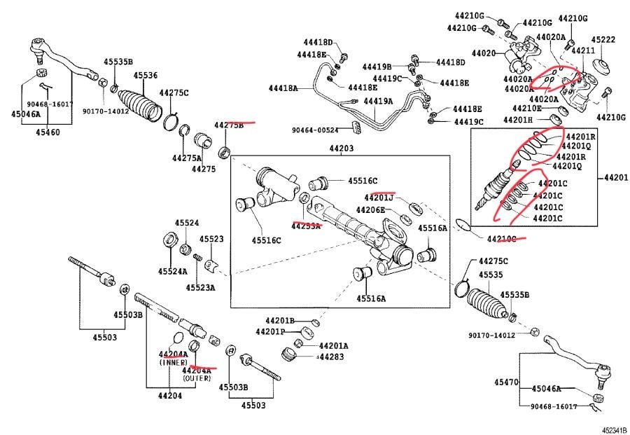

There are at least a dozen seals in a rack that definitely don’t last forever.
I tried to highlight them in the pic but i may have confused a bearing for a seal or vise versa at least once.
At 175k it’s safe to say there are likely some issues. Ask your Indy if he’d be willing to rebuild the existing rack.
The rebuild kits are available from Toyota and Lexus and hopefully he would do a more thorough job than a mass rebuild company with little accountability.
