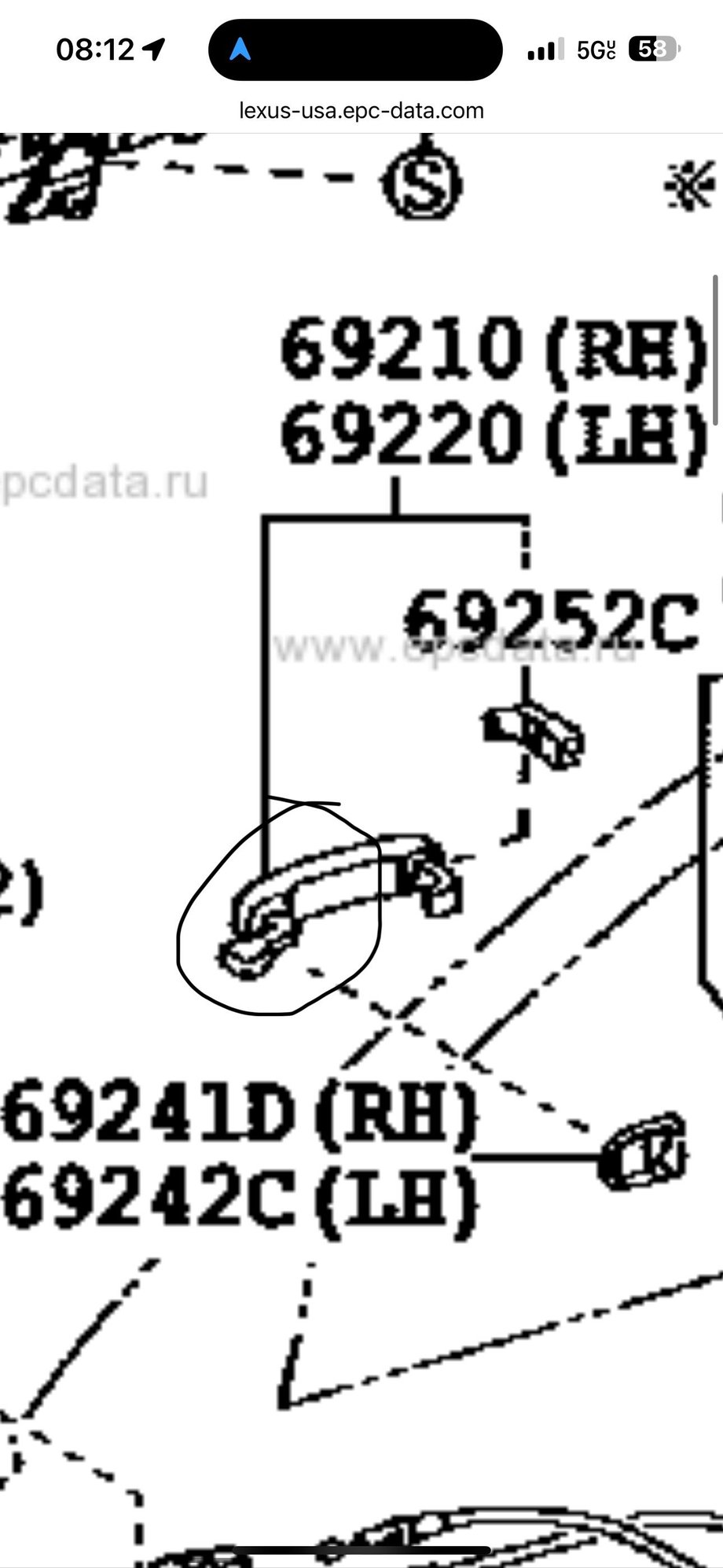

Originally Posted by BigBoomer
Not sure what part you are describing but the parts for the front door locks are here for 2001-2003 USA model LS430.
https://lexus-usa.epc-data.com/ls430...134/body/6703/
it’s this one I believe, it’s the mechanism that turns the latch to open. Wonder how hard getting that piece alone would be.

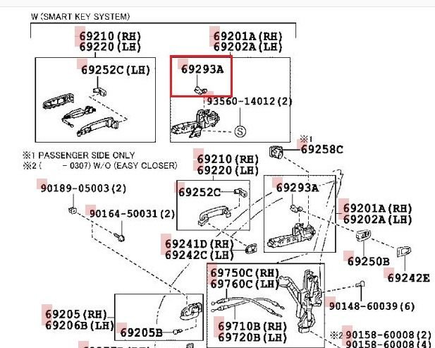

I think it's this? Hard to tell if it's for the handle or the lock.
Item 69293 = P/N 69293-12060; Snap
